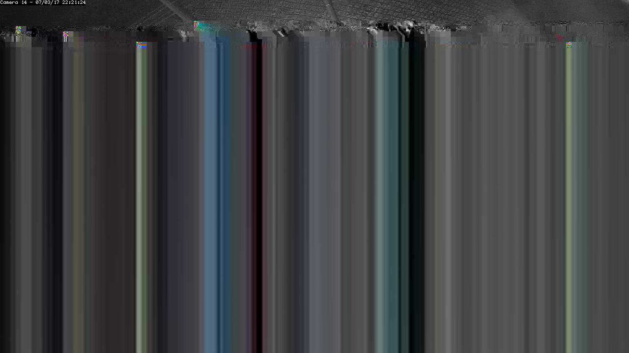

I'm getting a weird problem on many of my IP cameras at random times. Can anyone give me an idea of what could cause the problem with the attached image?

Is any of this helpful ?
search.php?keywords=ffmpeg+smearing

I'm sure it will, I wasn't aware it was called smearing. Thank you.

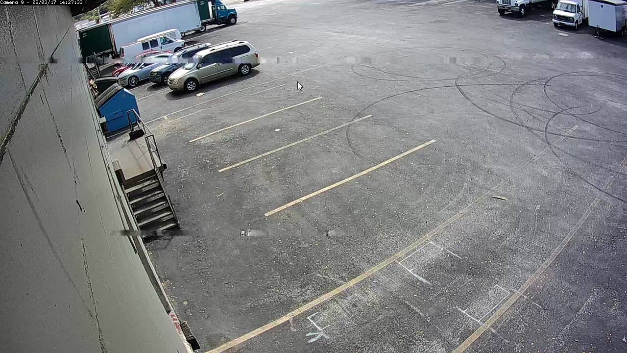

So I've been playing with this and it seems changing the colorspace from 32bit to 24 bit has made them much more stable. Now I'm seeing glitches on the screen that are not as severe, is this also called smearing?
2017-03-08 14_27_30.jpg (204.33 KiB) Viewed 10812 times

That is more like an artefact maybe caused by some missing data in the stream. Try the setting below if not already.
Smearing becomes a bigger issue with high res cameras running in UDP mode, it fills the buffers and image just finishes on the last row of pixels it got and it's like someone smeared the image down the page. For me swapping to Remote Method in the ffmpeg monitor to RTP/RTSP seemed to have the best results, you will see references to putting ?tcp in the url, this setting does that in the FFmpeg API.

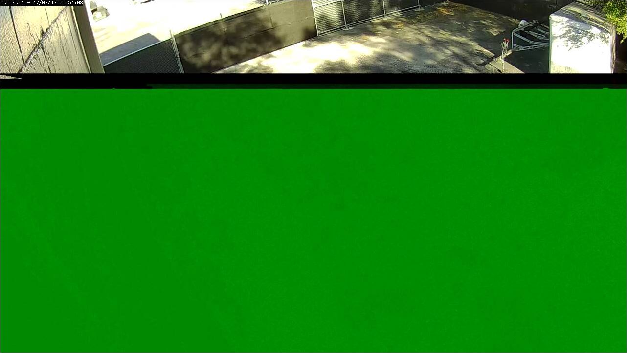

Yeah I'm still having a lot of problems with the system. I have the cameras set to run on TCP, but you can see my settings below. I have also attached a few screenshots.
Settings
Settings
2017-03-17 10_13_55.jpg (34.92 KiB) Viewed 10728 times
Unknown cause?
Unknown cause?
2017-03-17 10_13_20.jpg (76.73 KiB) Viewed 10728 times
MOCORD - All events are smears/artifacts.
2017-03-17 10_13_10.jpg (11.66 KiB) Viewed 10728 times

Tuxxin
Posts: 14
Joined: Fri Jan 06, 2017 3:09 pm
Re: FFMPEG IP Camera Buggy Snapshots
Post by Tuxxin »

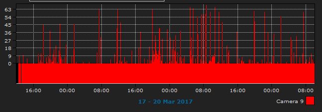

Well I let it run over the weekend, it doesn't have seemed to have helped. 423 events and 419 events on the 2 active cameras.

Tuxxin,
From your screenshot Remote Method = RTP/Unicast is still UDP. Change that to RTP/RTSP.
