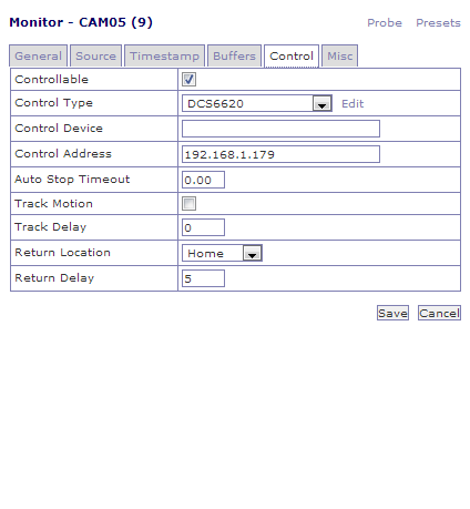

Did you have any success with this issue? I also have all my cameras setup (PZ8111 and DCS6620) and have saved home positions setup. If I click the home button in zoneminder control screen, cameras to go their home position, as expected. However, nothing happens when I try to use the "Return Location = Home" feature. I don't even know where to even start debugging this. Any idea what errors I should be looking at in the log? Thanks.
Getting this feature working is really critical since saved zones will only work from a saved preset.
