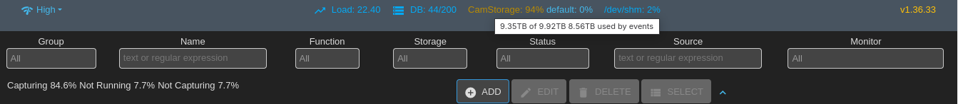

I’m encountering an issue with my ZoneMinder setup where the disk usage for events appears to be higher than what’s reported in the web interface. The events are stored on a separate disk, but ZoneMinder shows less space usage compared to the actual usage on the disk (which is 10TB in total).
Here’s the situation:
I’ve noticed that the disk usage shown in ZoneMinder’s web interface is lower than what the disk is actually using.
I’m concerned that deleted images, events, or other files might still be taking up space, or that there’s an issue with how ZoneMinder handles disk space.
I’d appreciate any insights on how to better manage disk space and troubleshoot this issue.
Thanks in advance for your help!

Re: Disk Space Usage Higher Than Reported in ZoneMinder
Currently, the total size of all events displayed in the ZoneMinder web interface is 5.05TB (even less than what I originally shared in my screenshot). However, the disk I allocated for ZoneMinder is 10TB in total.dougmccrary wrote: ↑Sat Feb 22, 2025 9:13 pm Probably system-reserved space. Default is 5%.
See tune2fs command.
Even if the system reserves 5% of the space, that would account for around 512GB, but my disk usage is currently showing 8.9TB full. This still doesn’t explain the large discrepancy between the reported event size and the actual disk usage.
Zoneminder web gui says something else

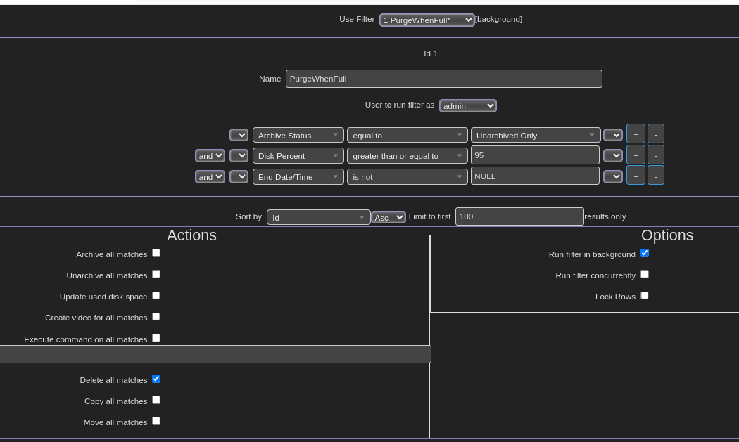

What do your filters look like?Currently, the total size of all events displayed in the ZoneMinder web interface is 5.05TB (even less than what I originally shared in my screenshot). However, the disk I allocated for ZoneMinder is 10TB in total.
According to what?but my disk usage is currently showing 8.9TB full.
There's a bit of overhead in the filesystem directories - how much depends on how you formatted and what storage scheme you're on.
