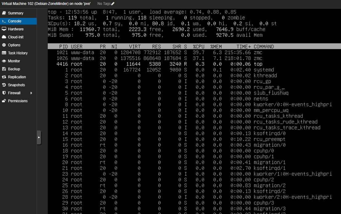

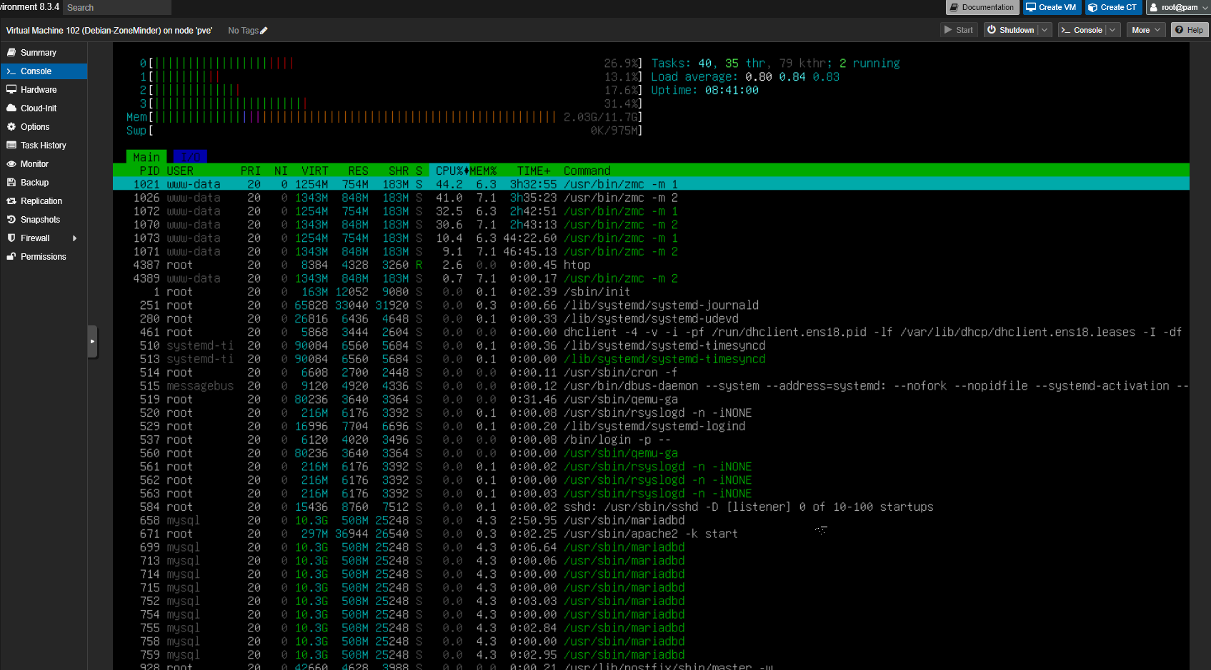

Re: Memory leak after update version zoneminder at ubuntu 24.04 amd64
Forgot to respond, so here the pictures after restart reported on VM and htop.
Once reach a level stay there 95 % of total memory. I had lowered the memory allocation and number of "CPU's" for this VM. I do small scale testing for now.
Debian12, 2K cameras on full resolution, passtrough method, unlimited buffer.
- 2025-03-06 12_54_06-Clipboard.png (168.25 KiB) Viewed 23638 times
- 2025-03-06 12_46_21-Clipboard.png (163.82 KiB) Viewed 23638 times
- 2025-03-06 12_47_39-Clipboard.png (296.64 KiB) Viewed 23638 times
