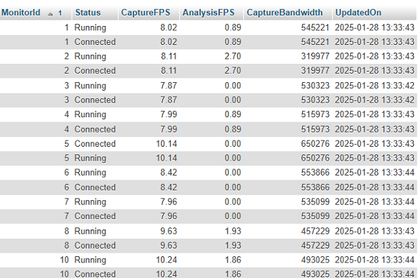

I just upgraded from 1.36.33 (debian repo) to 1.36.35 (zmrepo) and I am getting duplicate monitors showing. The Monitor_Status table appears to be duplicating MonitorID's. I did try clearing the table and running zmupgrade.pl but it adds the duplicate id's on each startup of zoneminder.

I figured this out, MonitorID was not set to be a primarykey. Once I set it to be the primarykey it worked correctly.
