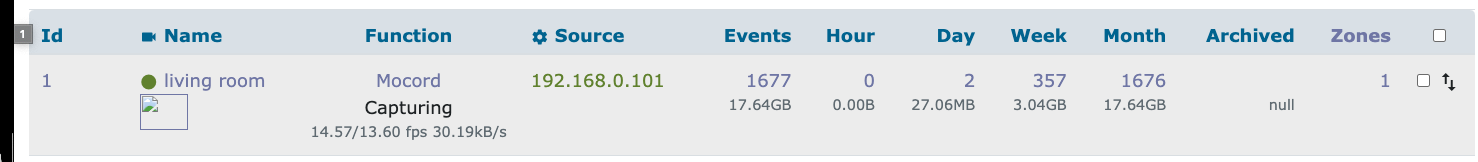

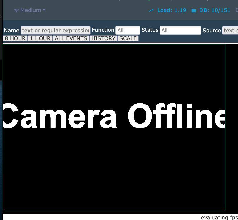

Hello Zoneminder Community,
Issue - My Anpviz 5mp ip camera records and zoneminder is able to do analysis but the software keeps telling me that the camera is offline in the montage view.
Background - The zoneminder installation is on 1.36.35 deployed on FreeBSD 14.2 jail. There is 1 camera connected through the wired network and visible through the network (can login to the camera and configure it).
Steps have done so far
1. Confirmed the php.ini files have the timezone (as this appeared to be a common resolution)
2. Used camera software on mobile device, that the camera can do live feeds
Objective - To get the montage view operational to be able to have a centralized location for viewing and monitoring the camera(s).
Thank you in advance for any tips or tricks for resolution of this issue.
Kind Regards,
Chris
