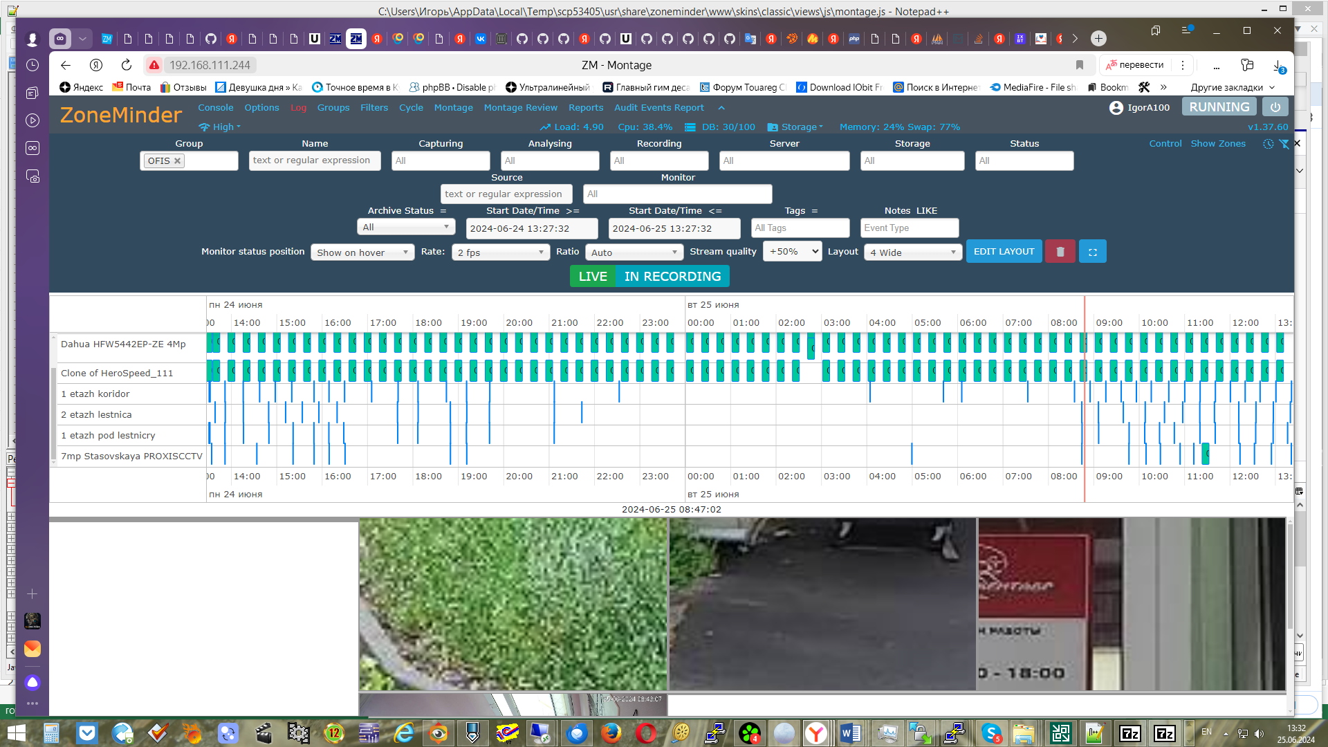

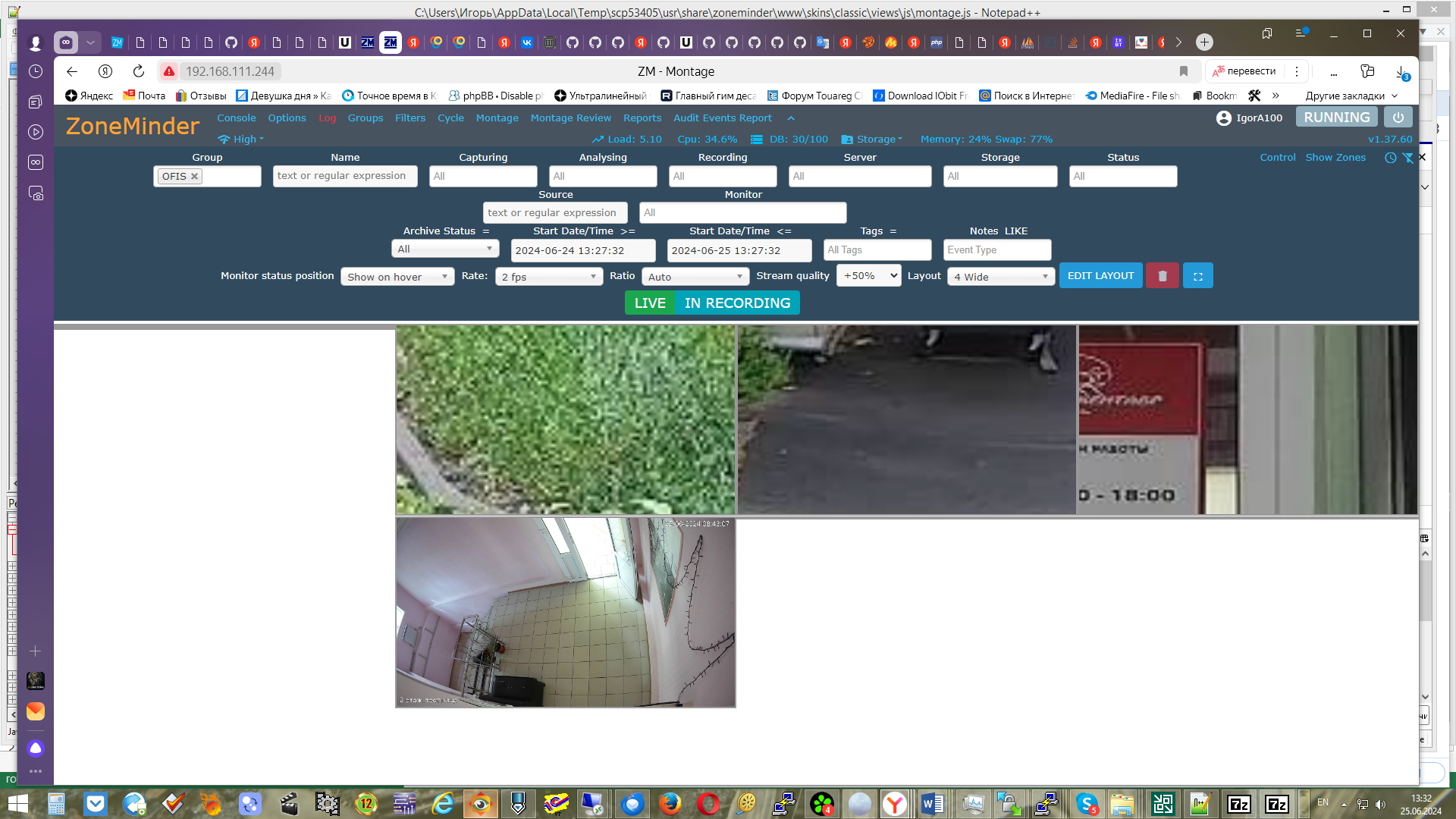

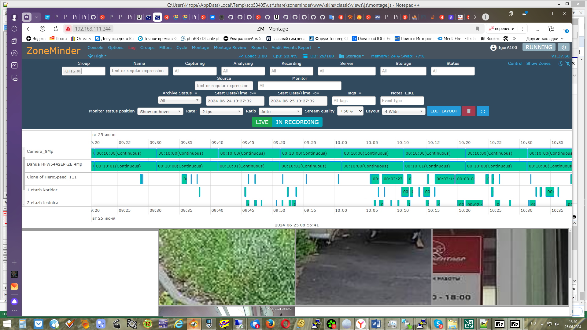

Work is underway.
A lot has already been done, but much remains to be done.
Montage page and Montage Review page are now on a single Montage page. All switching between modes occurs via AJAX without reloading the page.
The timeline is zoomed and panned with the mouse, and events on it are drawn dynamically. You can also add control buttons (Zoom, Pan), but I’m not yet sure if this is necessary, because... The interface is already overloaded with elements.
From the basic points, it is also necessary to implement a transition to the next event when viewing. Now, when you double-click on the timeline, the search and playback of events starts, taking into account the start from a certain frame relative to the time on the timeline. After the current event has finished playing, nothing happens.
Buttons will also be added for quickly selecting a timeline range (last hour, last 8 hours and last day) as on the Montage Review page.
Also, a full-fledged event filter has not yet been implemented; only the time range and displayed monitors are applied.
I still have a lot of ideas that need to be implemented.
Visually this is what happens.

It will be necessary to send requests at a certain interval. Most likely, requests will be sent for each camera separately, because... events can last for example 5 seconds or 10 minutes.
SELECT p1.Id, p1.MonitorId, p1.Width, p1.Height, p1.Length, p1.Frames, p1.Archived, p1.Cause, p1.StartDateTime,
UNIX_TIMESTAMP(p1.StartDateTime) AS StartTimeSecs,
CASE WHEN p1.EndDateTime IS NULL THEN (SELECT NOW()) ELSE p1.EndDateTime END AS EndDateTime,
CASE WHEN p1.EndDateTime IS NULL THEN (SELECT UNIX_TIMESTAMP(NOW())) ELSE UNIX_TIMESTAMP(p1.EndDateTime) END AS EndTimeSecs
FROM Events AS p1
INNER JOIN
SELECT a.mId, a.StartDateTime, MAX(a.StartDateTime) AS maxStartDateTime
FROM (
SELECT E.MonitorId AS mId, E.StartDateTime, UNIX_TIMESTAMP(E.StartDateTime) AS StartTimeSecs,
CASE WHEN E.EndDateTime IS NULL THEN (SELECT UNIX_TIMESTAMP(NOW())) ELSE UNIX_TIMESTAMP(EndDateTime) END AS EndTimeSecs
FROM Events AS E
#WHERE 1 > 0
)a
WHERE ((StartTimeSecs<1718867418) AND (mId IN (5,6,20,15,33,37,38,41)))
GROUP BY mId
) AS p2
ON p1.MonitorId = p2.mId
AND p1.StartDateTime = p2.maxStartDateTime
order by p1.StartDateTime desc;
WHERE (mId IN (5,6,20,15,33,37,38,41))
The execution time of an SQL query is about 200ms, which is certainly a lot. But I don’t have any other thoughts about searching for events yet
When initializing the monitor grid, I want to display not a black square, but the last frame of the last event, i.e. one request 200ms. An event request is also generated for display on the Timeline (I indicated the request text above), this is a fairly fast request of about 15ms.
Then when I double click on the Timeline I run a query to get the events that I want to fire. The query is similar to this:
SELECT a.* FROM (SELECT
E.Id, E.MonitorId AS mId, E.Width, E.Height, E.Length, E.Frames, E.Archived, E.Cause, E.StartDateTime AS StartDateTime, UNIX_TIMESTAMP(E.StartDateTime) AS StartTimeSecs,
CASE WHEN E.EndDateTime IS NULL THEN (SELECT NOW()) ELSE E.EndDateTime END AS EndDateTime,
FROM Events AS E
WHERE 1 > 0
)a WHERE ((StartTimeSecs<1719384072 AND EndTimeSecs>1719297672) AND (mId IN (5,6,20,15,33,37,38,41)));
WHERE ((StartTimeSecs<1719384072 AND EndTimeSecs>1719384072) AND (mId IN (5,6,20,15,33,37,38,41)))
Next, I need to find the next recorded event, and I haven’t decided how to do it yet.
Re: Upgrading Montage Review page
Yes, it works fine. But if I want to get not the next event after a certain date, but the most recent event, then this code returns not the most recent event for the monitor, but the very first.iconnor wrote: ↑Wed Jun 26, 2024 1:14 pm I think since you want to return the last event for all the monitors... you will have to use MAX. It should work fine on the existing columns. You could use Max(Id) as well.
SELECT *, MAX(Id) AS MaxID FROM Events WHERE StartDateTime > $whatever AND MonitorId IN (1,2,3,4) GROUP BY MonitorId;
SELECT *, MAX(Id) AS MaxID FROM Events WHERE MonitorId IN (1,2,3,4) GROUP BY MonitorId;
Yes Id is the primary key. Always incrementing unless we are recovering old lost events.
You can use EXPLAIN and EXPLAIN ANALYZE to diagnose query speed. Sometimes mysql does non-obvious things. For example what you ORDER BY on can make it NOT use the index on StartDateTime.
Final queries that I plan to use:
*** We get the NEAREST NEXT event after the specified date FOR A GROUP of monitors: (90ms)
* Only the event ID will be correct in the answer, the rest will be random.
* - I don’t use it yet.
*** We get the NEAREST NEXT event after the specified date FOR ONE monitor: (1ms) SUPER
* ALL information in the answer will be correct.
* + Called in the background when events are played back.
*** We get the NEAREST PREVIOUS event before the specified date FOR A GROUP of monitors: (90ms)
*** We get the NEAREST PREVIOUS event before the specified date FOR ONE monitor: (1ms) SUPER
*** We get the ABSOLUTELY LAST event FOR A GROUP of monitors: (90ms)
* Used extremely rarely, only at the time of grid formation to initially display a static frame instead of a black square
***Sampling by double clicking on TimeLine (Looking for events to play now FOR A GROUP of monitors) 80ms:
***Sampling for displaying events on TimeLine FOR A GROUP of monitors 2-4ms (SUPER FAST):
*Used with Zoom & Pan Timeline
Thus, fast queries of 1ms will be executed in the background; when navigating through the TimeLine, fairly fast queries of 2-4ms are executed. And slow queries of 80-90ms are executed extremely rarely.
I think this is a good solution.
There is one unpleasant moment that I don’t know how to solve yet.
When changing "Stream quality" (essentially changing Scale) or "Rate" I change the URL for the event. If the event is playing at this moment, it stops and starts playing from the "frame" originally specified in "src". As a result, playback becomes out of sync.
1. I could change “frame” in “src”, but firstly I don’t know how to get the current “frame”, and secondly, replacing “frame” takes time (while the frame is changing it will still jump, although not big)
2. You can try to stop the playback of all events and start them again approximately (+/- 1 second error) from the moment they were stopped.
How to be?
How to be?
We can add support for passing frame time instead of frame #.
