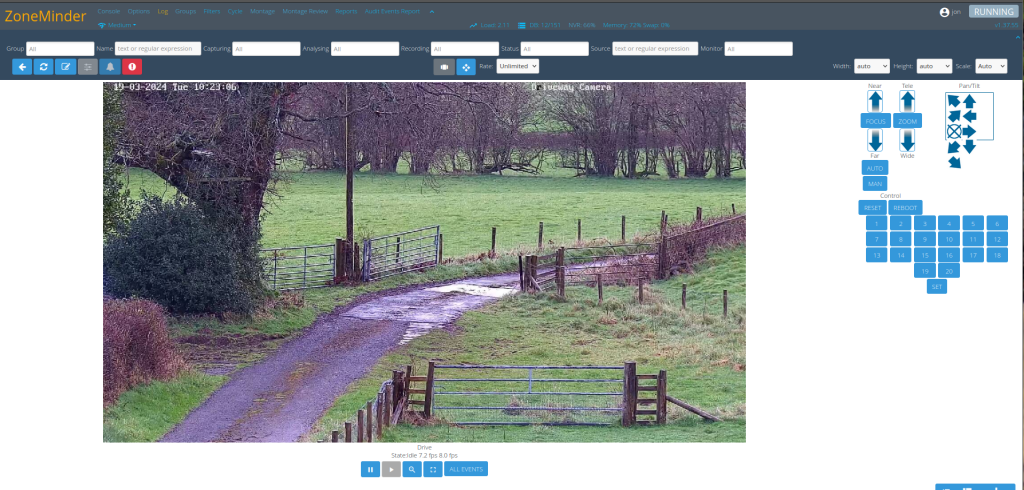

My controls don't align properly and I don't think they ever have, and I seem to have lost the ability to set a preset since doing an update yesterday.
I use Firefox, and am currently on 123.0.1

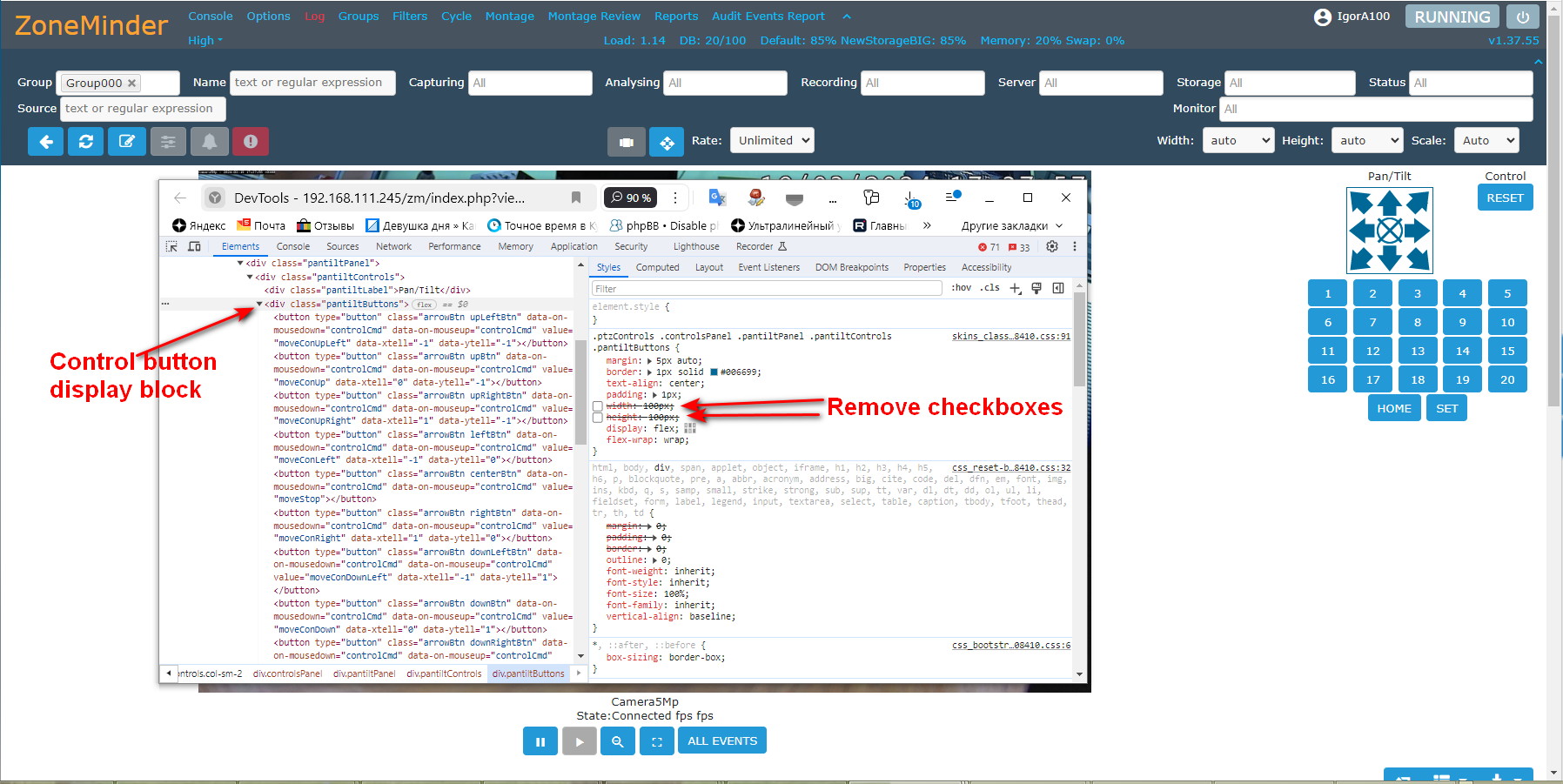

I'm not 100% sure, but it should work:
Enable developer mode in the browser and remove 2 checkboxes (as in the picture) for the button control block.

Check your browser's zoom setting.
It's probably less than 100%.
iamnotme
Posts: 23
Joined: Mon Aug 29, 2022 9:21 am
Re: Web page controls layout and preset not working
Post by iamnotme »
IgorA100 wrote: Tue Mar 19, 2024 7:10 pm Check your browser's zoom setting.
This was indeed the problem, thanks for the suggestion and taking time out to respond. It never even occurred to me and I don't remember changing the zoom level so must have been a long time ago.
