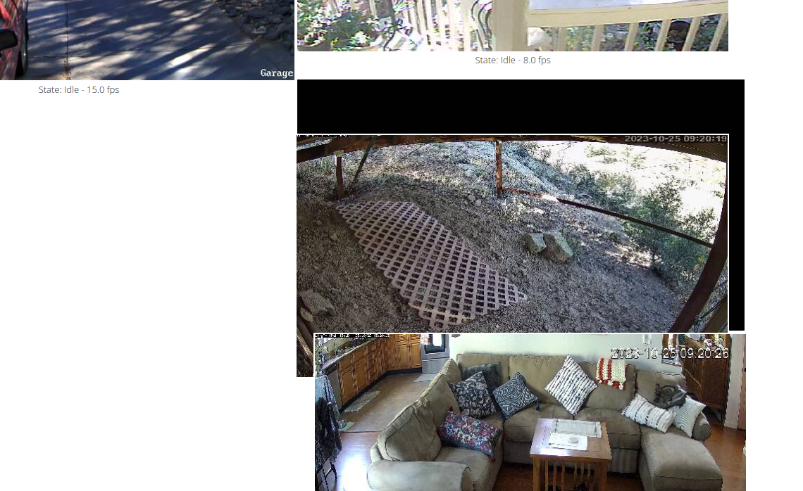

Yes, I can create montage layouts and every time I fire up a browser to go use that, the camera's are all messed up, all over the place, not where I saved them.

Yes, I know I can move the cameras in the console but when you use montage, you set them up in columns and rows. That's what never sticks, the columns and rows that I've saved.

Can't really show anything since it's all personal locations in the house.
When you go to Montage, you have pre-set options, 2, 3, 4 across etc.
Depending on the width of the camera image, this works or doesn't work. Not only might only two images show up in the 3 columns but some of the images are outside the edge of the browser for example. If I select a Width, then it might work but it might not again, with images showing up all over the place, not lined up.Even if I save a custom montage layout, it never shows up as I saved it.

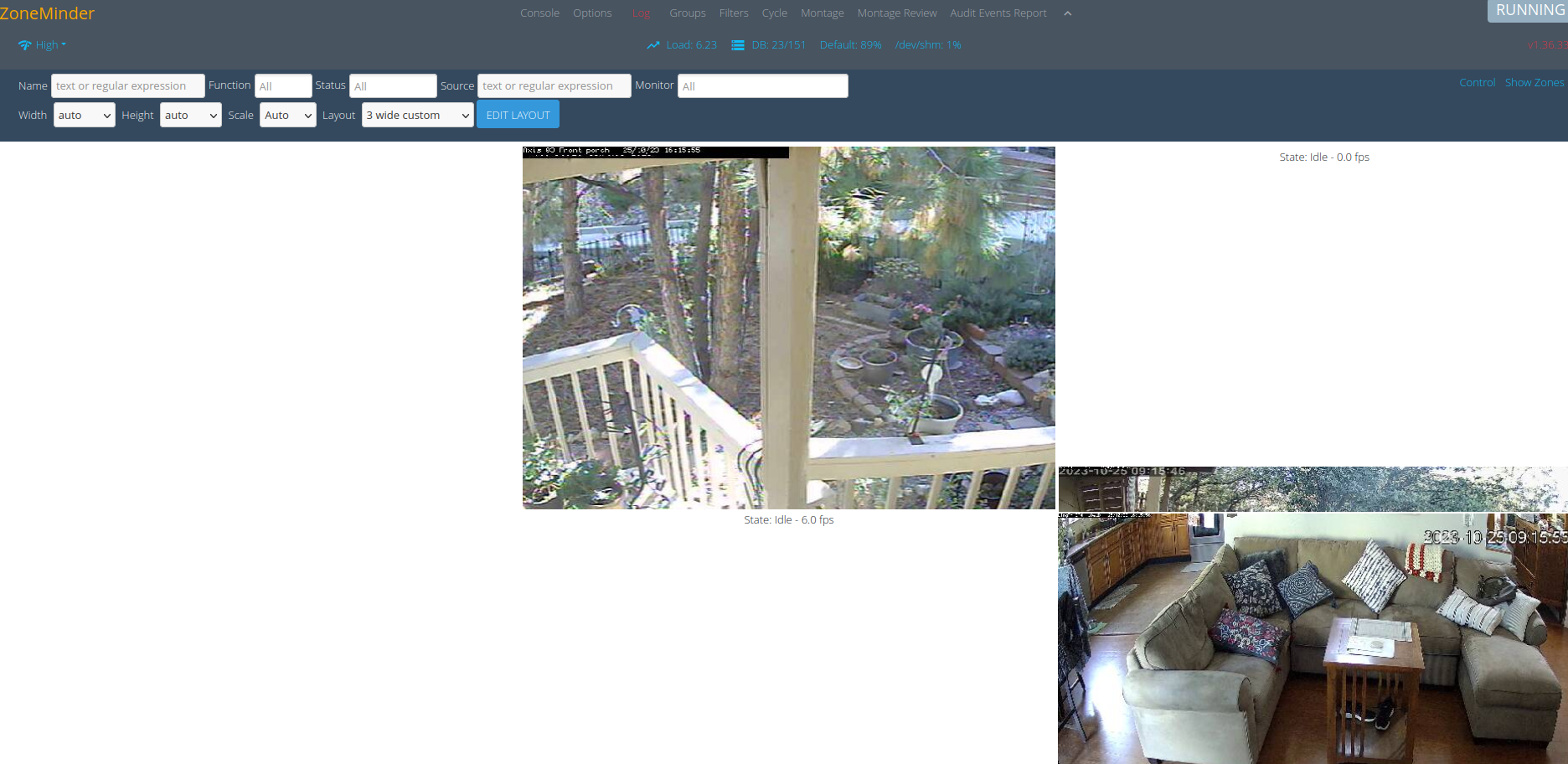

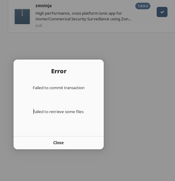

Well, I wanted to try zmNinja on my Manjaro desktop but;
As for the montage, In this case, I had a 3 row layout but when I click on it, it's always broken. I have to use Edit and even if I save it, it's broken the next time I use the layout. By the way, there are six cameras but they are all over the place which is why I have to edit each time to bring them back together.
This happens on my Linux desktop, Windows 10, 8 and 7.

Re: Windows or Linux app for montage
It seems impossible that others aren't seeing the same issue. This happens no matter which PC or browser I use.
