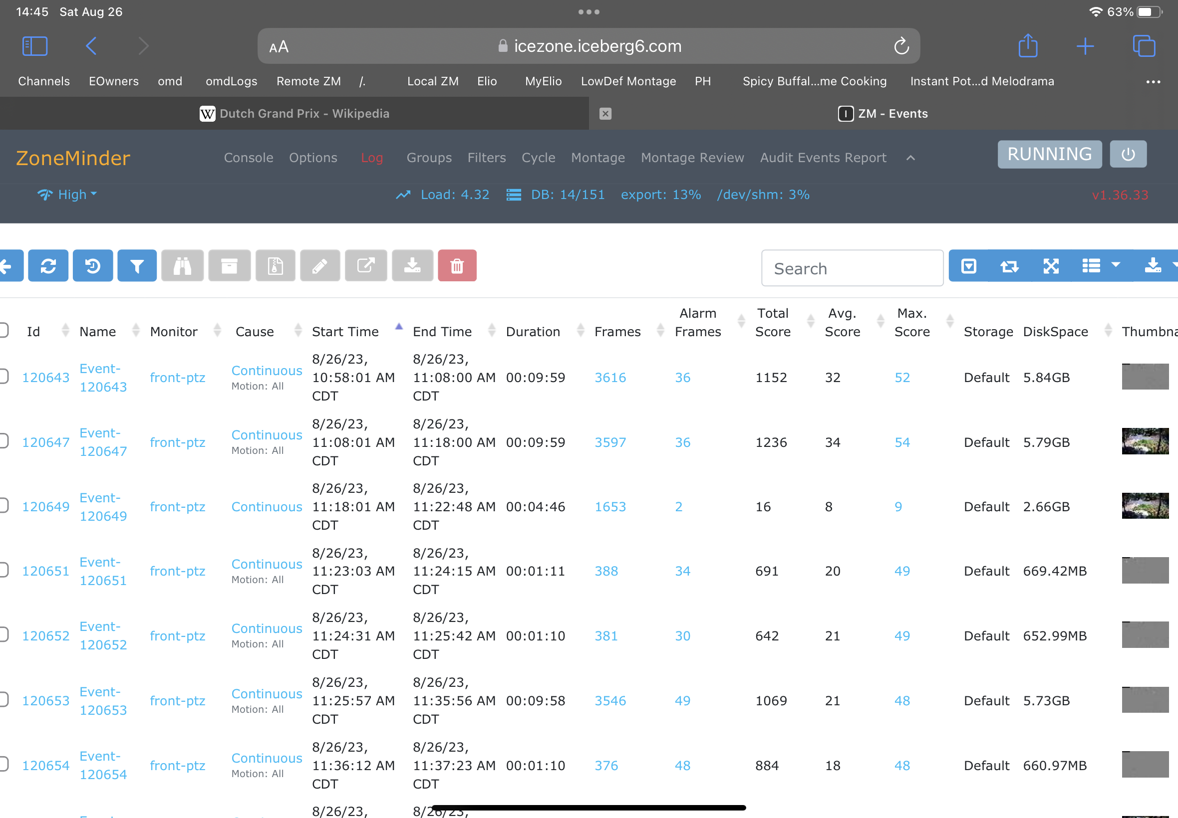

When I access ZM via safari I my iPad I see some annoying behavior between landscape and portrait orientation. The list of events is overflowing the viewable space. I portrait I don't see the check boxes at all, landscape is slightly better but still not quite right. This isn't a zoom issue, I can't zoom out to see the whole interface at all. It's actually worse in chrome on the iPad, can't see the check boxes at all in both orientations.

I am somewhat aware of poor layouts on various devices...
One thing you can do is turn off some of the columns...

And there's my Duh moment for the weekend. Should have figured that one out on my own.

How do you set the default view? Deselecting some of the columns that I don't care about does fix the original problem. But when I go back into that view all the columns are in view again. How do I save the layout that I want as a default? Looked through options and didn't see any setting for this.

Just found this github issue with a fix that seems to work pretty well.
https://github.com/ZoneMinder/zoneminder/issues/3671
