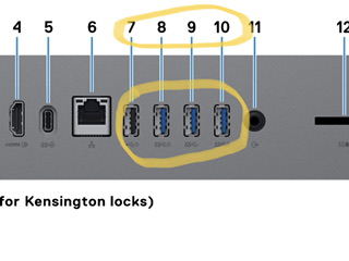

Re: archives deleted after Ubuntu firmware update
The forum does accept pictures.
- IMG_0410.jpeg (18.85 KiB) Viewed 3766 times
Let me clarify.
The server running ZM is not used for the internet except for updates. All this server does is run ZM and check for updates. I have to move debug files and other info to this workstation. Attachments only accept .TXT.
