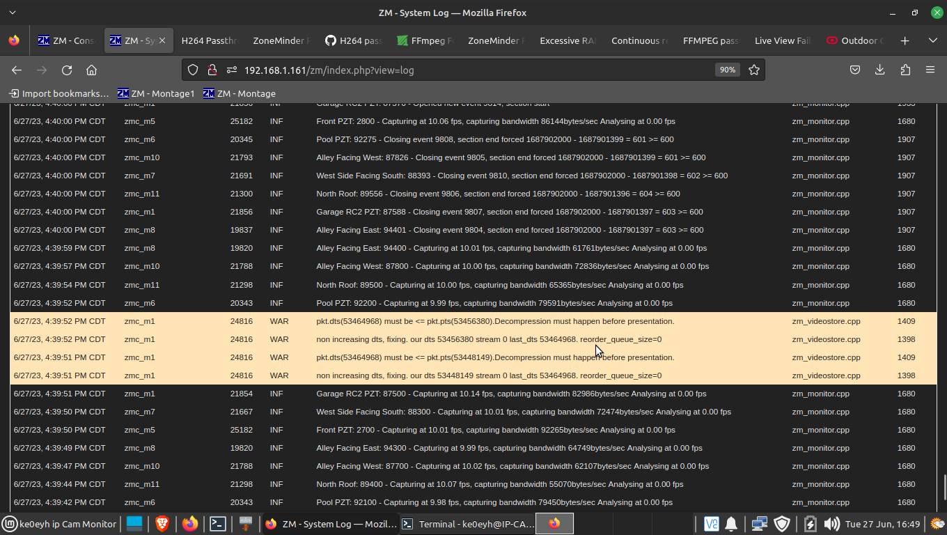

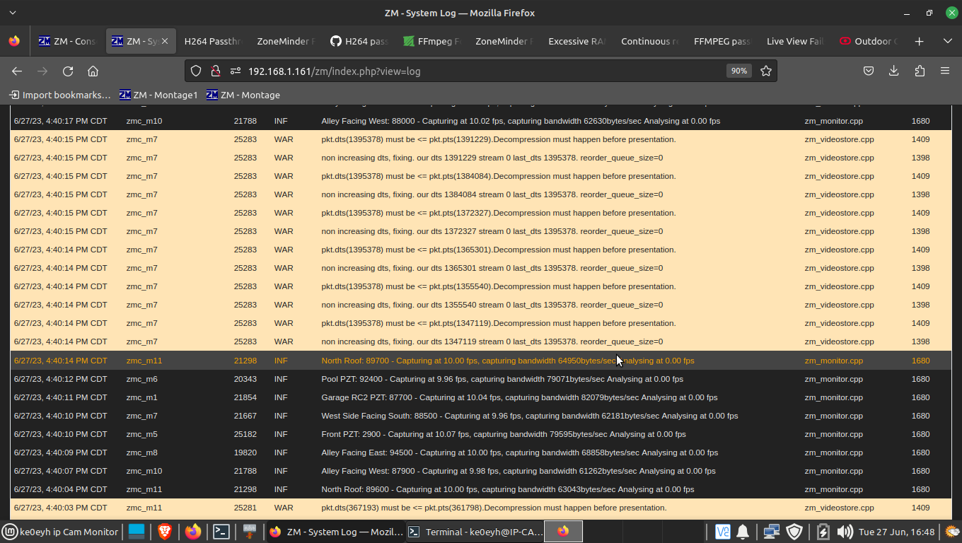

Here are some of the logs I currently have, I've tried several different things that I have read here in the forums but nothing seemed to help. I will attach some screen shots as well.
6/27/23, 4:40:03 PM CDT zmc_m11 25281 WAR pkt.dts(367193) must be <= pkt.pts(361798).Decompression must happen before presentation. zm_videostore.cpp 1409
6/27/23, 4:40:03 PM CDT zmc_m11 25281 WAR non increasing dts, fixing. our dts 361798 stream 0 last_dts 367193. reorder_queue_size=0 zm_videostore.cpp 139
6/27/23, 4:41:37 PM CDT zmc_m5 25375 WAR Option video_codec_id not recognized by ffmpeg zm_ffmpeg_camera.cpp 341

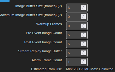

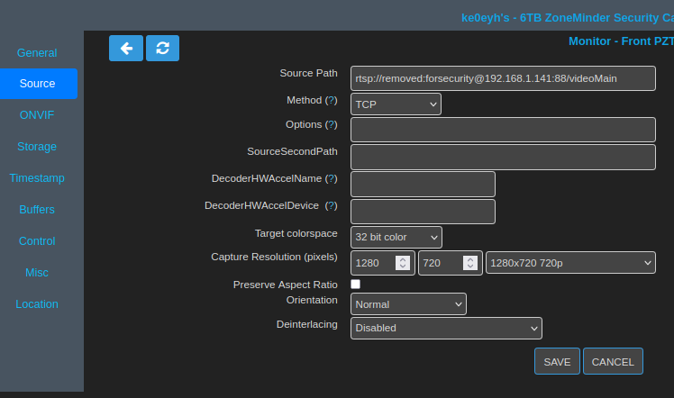

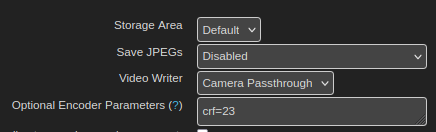

- Screenshot_2023-06-27_17-03-17.png (21.2 KiB) Viewed 5431 times
- Screenshot_2023-06-27_17-02-51.png (11.74 KiB) Viewed 5431 times
- Screenshot_2023-06-27_17-02-23.png (32.49 KiB) Viewed 5431 times

Attaching a couple more screen shots
- Screenshot_2023-06-27_16-49-12.png (296.29 KiB) Viewed 5430 times
- Screenshot_2023-06-27_16-48-47.png (292.04 KiB) Viewed 5430 times
Re: Camera recording with passthrough works but no live montage view
Whether it's just a symptom or an actual cause, I don't know. For timing problems like this, look at reorder_queue_size. Also try TCP, rather than UDP.

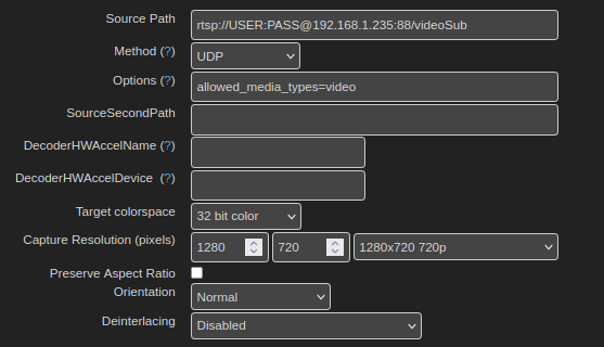

In Source/Method use TCP
In Source/Options leave blank
If you used ONVIF to add your cams trust the settings except for the two above
Thank you!
I started out with those settings at first, but I did go back and blanked the options and set them back all to TCP
I didn't use ONVIF because It stops at choose detected profile and there's none in the drop down box and next is grayed out.
Still no live view in Montage. Now if I go back and only disable "Video Writer" I will get the live views in Montage like one would expect. I'll attach screen shots

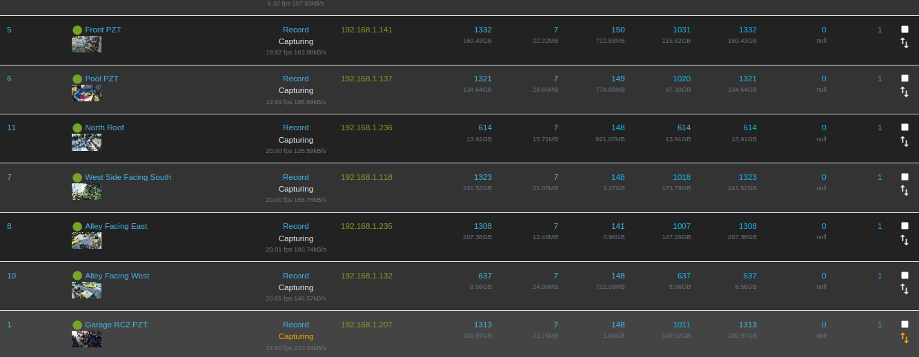

- Screenshot_2023-06-28_18-59-50.png (46.45 KiB) Viewed 5387 times
- Screenshot_2023-06-28_18-59-07.png (27.63 KiB) Viewed 5387 times
- Screenshot_2023-06-28_18-58-24.png (74.12 KiB) Viewed 5387 times

And here is the result if I disable "Video Writer".
That's the only change I made to each camera
- Screenshot_2023-06-28_19-06-42.png (21.7 KiB) Viewed 5386 times
- Screenshot_2023-06-28_19-06-18.png (95.2 KiB) Viewed 5386 times

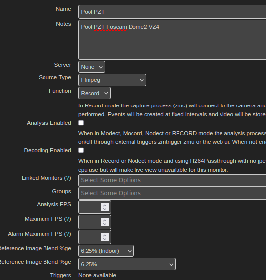

Sorry I missed your question -> "You are using ffmpeg source type?"

OK, I was somewhat mistaken about not needing to save jpegs.
In order to get live Montage, you need save jpegs set to anything other than disabled, AND/OR Decoding enabled on the General tab.
I'm uncertain if that's how it's supposed to work, but that's how it is on my 1.36.33, and reflects what the note at Decoding Enabled says.
Personally, I usually have Analysis images only with decoding off on cameras that don't need motion detection.
Thank you so much, that answers why I have great recordings and no live view. I do have another instance of ZoneMinder running on another PC that I use to monitor our cameras in our living room so I don't "need" to see the live view on my Ubuntu server. I just thought I had something set up wrong. My server is just a PC running Ubuntu Server and its a little under powered so I may need to upgrade to better hardware. I do still have some odd errors that I screenshot earlier up in our conversation. Can you point me in a direction to figure those out too? Or should make new post about those?
