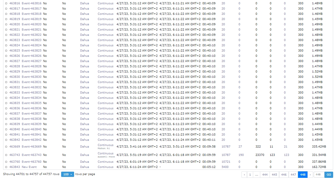

Hi, I updated from 1.34, and now one of my Cams just Produces hundreds of mini Files.
From Time to Time it works fine, but then it switches back to 20 Frame Files:
Where may i look?

Check your logs. These things don’t usually happen in silence. Seems like it’s crashing.

Post by jay23 »
Thanks.
After setting the Buffer Size to 0, it works.
But why it worked before?
Re: Hundreds of 20 Frames Files after update
You upgraded. Huge changes to ZM occurred.
