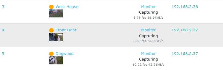

at current I have 6 cameras all just in monitor
5 of them are reolink rlc 410 setup Ffmpeg, rtmp, sub channel, I set the cameras to 640x480 and 10 fps
all of the reolink cameras have a yellow dot the stream is pretty good
I have one Amcrest camera set to about the same had to use subtype=0 to get it to work
It has a green dot
Is having a yellow bad?

Hello!

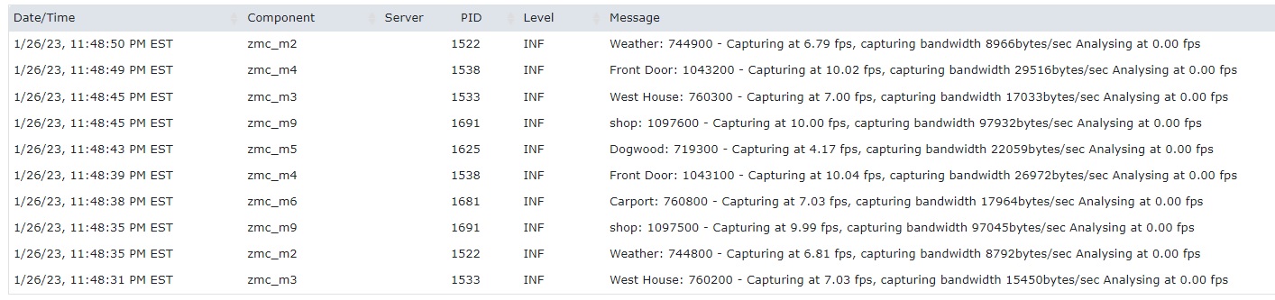

If I'm not mistaken, orange means that the monitor is receiving images but not doing anything else with them, while green means that both capture, analysis and recording are working properly.
Judging by the log, you don't have any analysis going on.

No i just stream them to a website but the amcrest which is shop cam does not do anything either but its green
