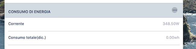

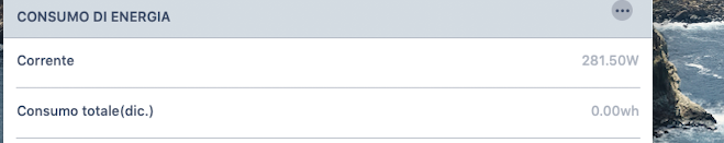

I update the consumption of Zoneminder
348 watt i'am use zoneminder
