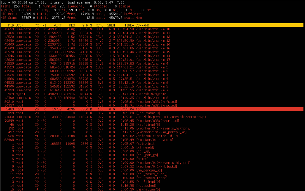

Re: Released 1.36.29 The Memory Remains
Presently one of the zmc processes is holding 13GB res and 15GB virt.
This is on .28 after restoring the VM. I'm not really wanting to reinstall .29 presently, but it was the zmc processes on .29, as well.
The memory usage on .28 as of this morning. I'm still wary of attempting to upgrade to .29 again because of that memory issue.
To get here, I had to restart individual monitors individually. The monitor which was holding more than half the VMs RAM is behaving itself - for now.
