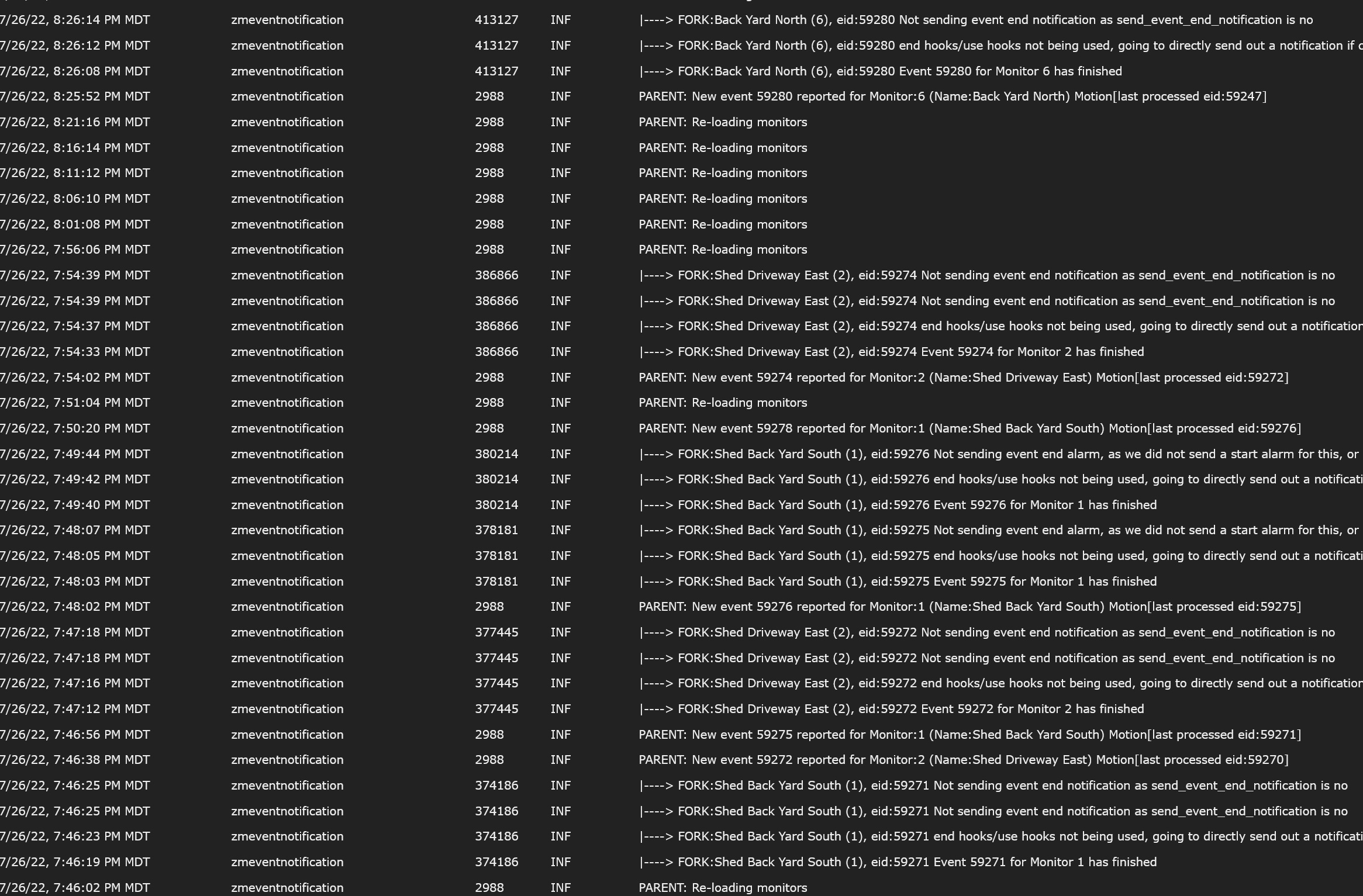

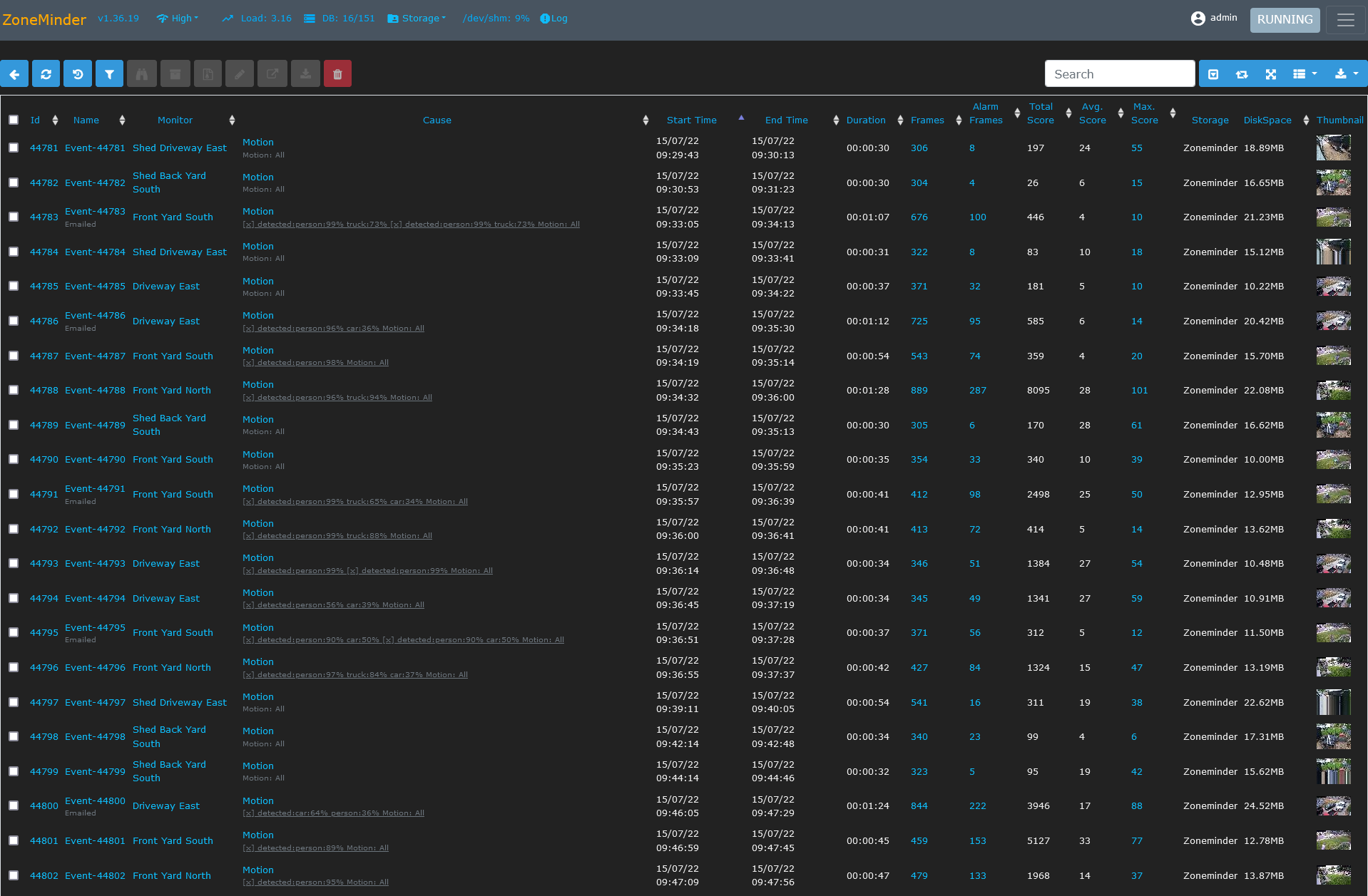

As the title says I am trying to figure out why ZMES is skipping some events for analysis, yet it is choosing to analyze others. I have attached a screenshot below. Any insight would be helpful.
Thanks,
Kalter
Thanks,
Kalter
- Screenshot 2022-07-16 at 09-30-39 Green River ZM - Events.png (303.68 KiB) Viewed 48254 times

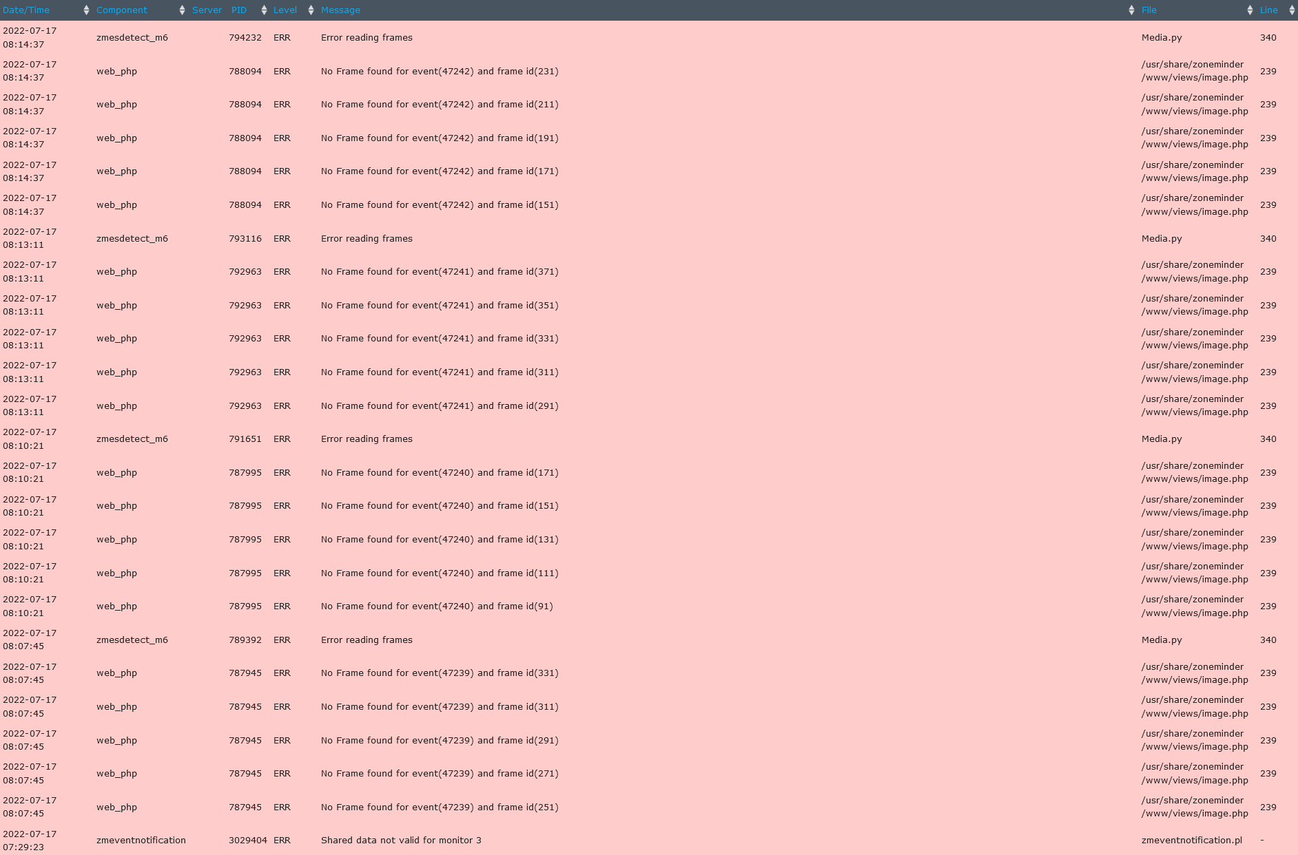

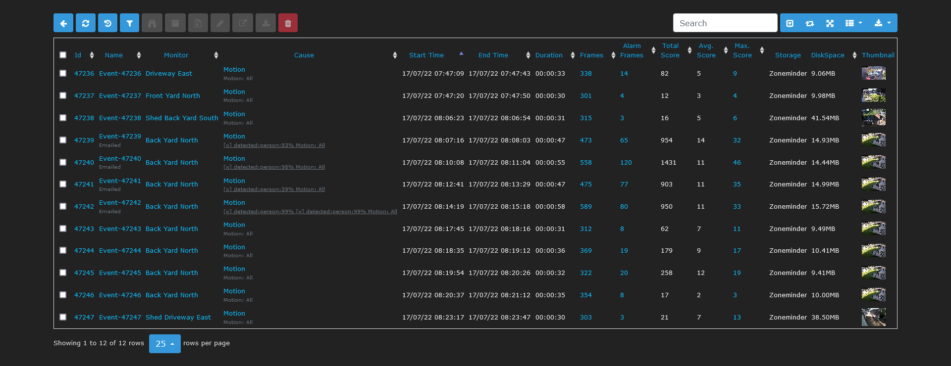

A little more information I found while watching the zm logs this morning. It does not happen with every event but I am getting some errors that pop up in the logs about Frame Reading, and No Frame found for event.
I am still watching logs this morning so I can see if I can catch it "in the act" nothing as of yet.

Those errors just mean that zmes asked zm API for that frame I'd (231) and zm didn't reply with the requested frame.of I remember correctly.
Are the monitors in question using video pass through? In my testing MP4 events are much slower for to zm needing to decode the MP4 and then grab a jpeg image from.the mp4

You can see in the logs in the screenshot that is attached that zmes is missing the events at random.....

1. When you post logs, please consider following the instructions, which involve debug logs. Link here. While you still may not get a definitive answer from the community, it will give both you and the viewers more places to look for problems. You've posted INF logs. Once you'll enable Debug logs, you'll see what the ES is trying to do for the failed events
2. If events such as 47242/47241 are examples of missed events, it looks like the detection logic is trying to access those frames but they are not available yet. You have multiple options, that you'll find in the documentation of the ML component:
a) Add a wait clause before the detection tries to grab frames (say wait=5 for that monitor)
b) Get more granular and play with the resiliency aspects for stream_sequence
