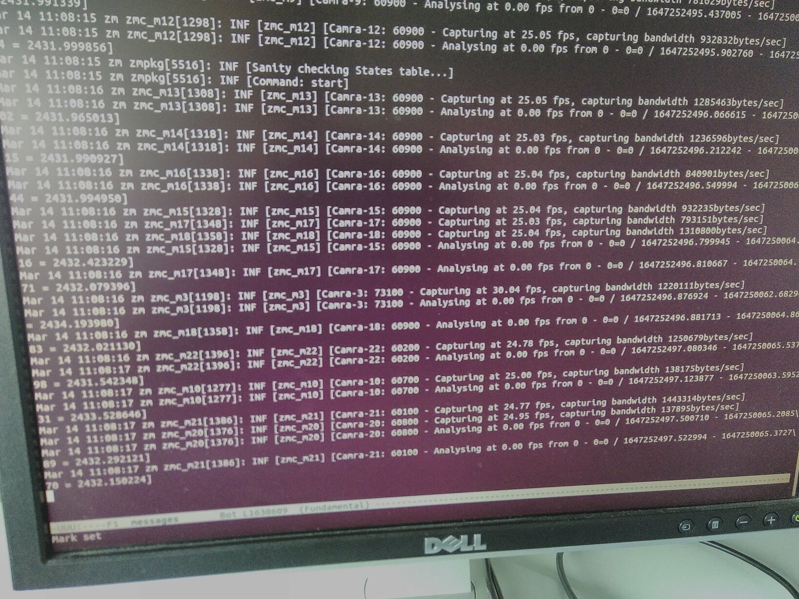

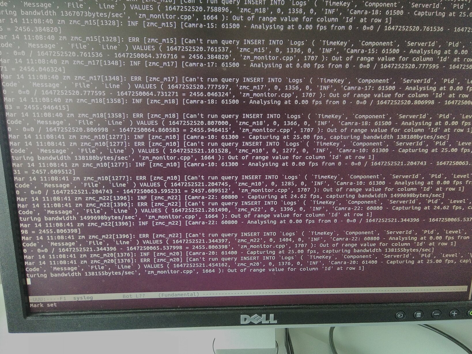

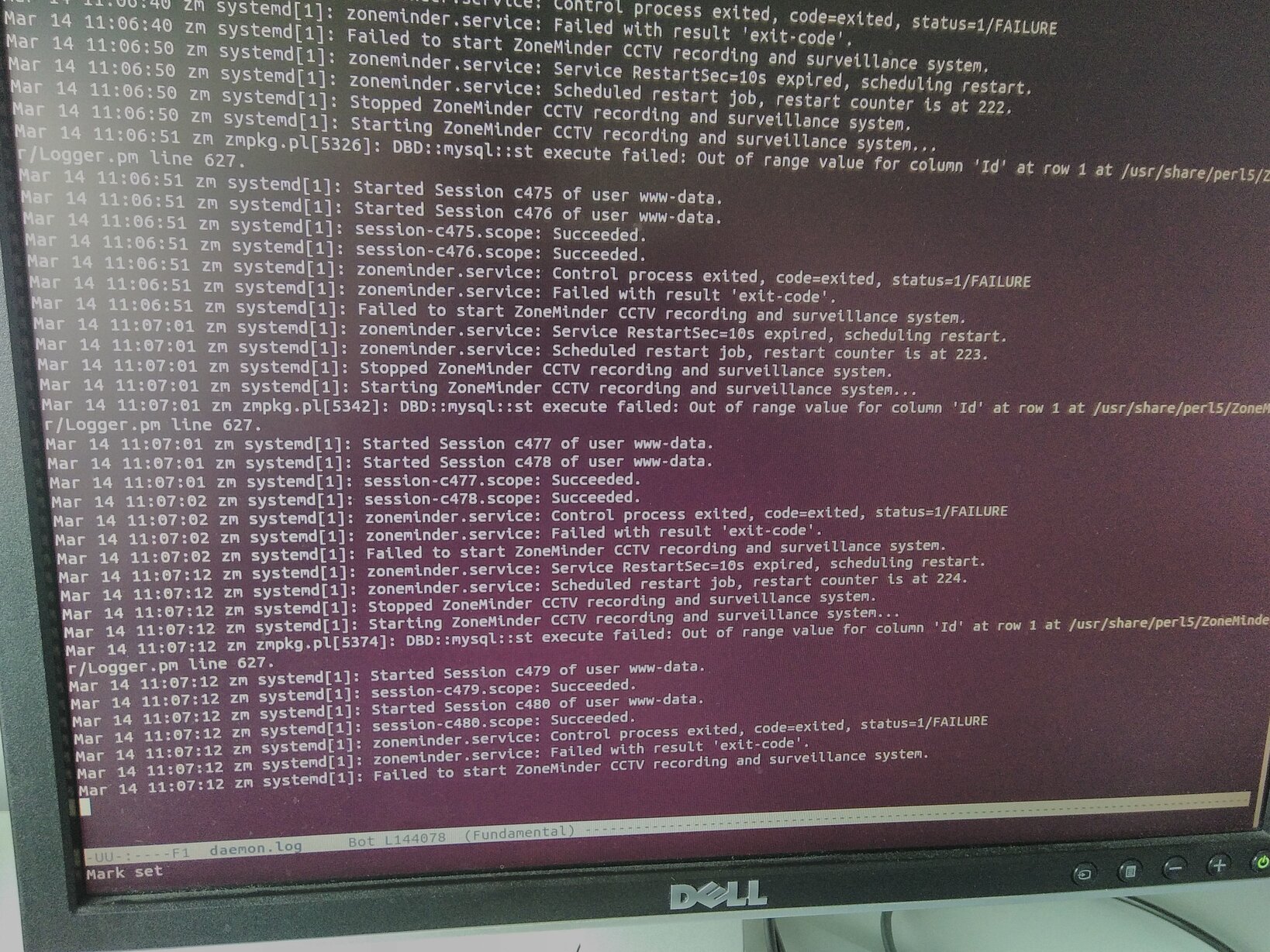

I have a debian buster with zm 1.36.5
It worked correctly until I had a full disk in /var (in fact it was inode full). I erased files to have free space and inodes. But now I can't start service zoneminder. As this computer is not connected to internet, I attach screen captures with logs.
In firefox, I have a blank screen.
As you can see, I have error message for mariadb, mariadb works correctly, but le table Logs is empty.
Thanks for help and ideas.

Re: service zoneminder fail starting
You'll have to tackle to DB the way I see it.
You could see what the value is that it's trying to use -
SELECT `AUTO_INCREMENT` FROM  INFORMATION_SCHEMA.TABLES WHERE TABLE_SCHEMA = 'zm' AND   TABLE_NAME   = 'Logs';
and see if that's the problem for the table.
