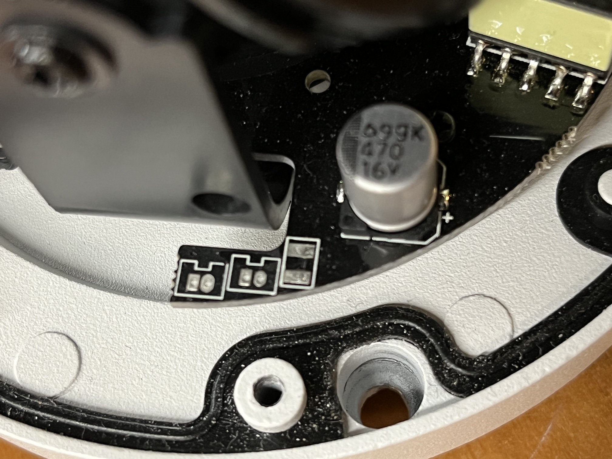

It's a long shot and they are less than $100 so I won't be upset if I need to toss it in the bin and buy a new camera.
I don't know what happened... I rebooted the PoE switch and it didn't come back up/online. I had the camera set as a static IP in the camera's web gui config. I had it set as IP address 192.168.1.12... And now I get nothing at that IP address but it does respond to pings at 192.168.1.152... Which is weird. My DHCP address range is 192.168.1.50-192.168.1.69... So I have no idea what on earth ever made it respond to pings at IP 192.168.1.152.
There is no reset button. It is a PoE IP camera and I do have both a spare PoE switch as well as the wall-wart power plug (so I can access it via laptop/pc without PoE).
There is no reset button. I have found ABSOLUTELY NOTHING online or anywhere about these cameras. They have to flash them at the factory somehow... To make things a little more complicated, the model --or the camera housing looks like it could also accept a PTZ (pan tilt zoom) camera as well as the el-cheap-o dome that I have. I attached one picture. On the side of the camera's board there is one spot where it **maybe** looks like you could short some jumpers and **maybe** reset the camera... I've tried but no luck.
It's already bricked: I can't break/brick it any worse... Any ideas?
I attached a photo. I tried to "jump", bridge or short those jumpers in various states of boot, running, etc. with no luck. I know the camera is working (mechanically) because I can hear it clicking when it turns on... But I cannot ssh (refused), tftp (also refused) or hit any http/https URL's of the camera (http times out, not refused)
Again, thanks for any ideas.

Those two spots in the photo are probably where they would solder something for a PTZ model. My guess is they used the same board. The two solder points look like a jumper of some sort. I've seen over on Level1 (https://forum.level1techs.com/t/unbrick ... ide/161470) Wendell un-bricked a hikvision camera but when I read through that DIY/tutorial it seems like the camera he was working on was --idk "better", higher quality, not as el-cheap-o as my camera...
I know something is there because something is responding to a ping. I've got the manuals and I've read them. There's nothing I can find to help with a reset or re-flash process/tool.

Are you sure that the device at 152 is the camera? I assume by determining mac address.
It might be in some sort of pre-boot environment like uboot. It MIGHT respond to a tftp setup. You might also look for more spots that look like jtag headers.
