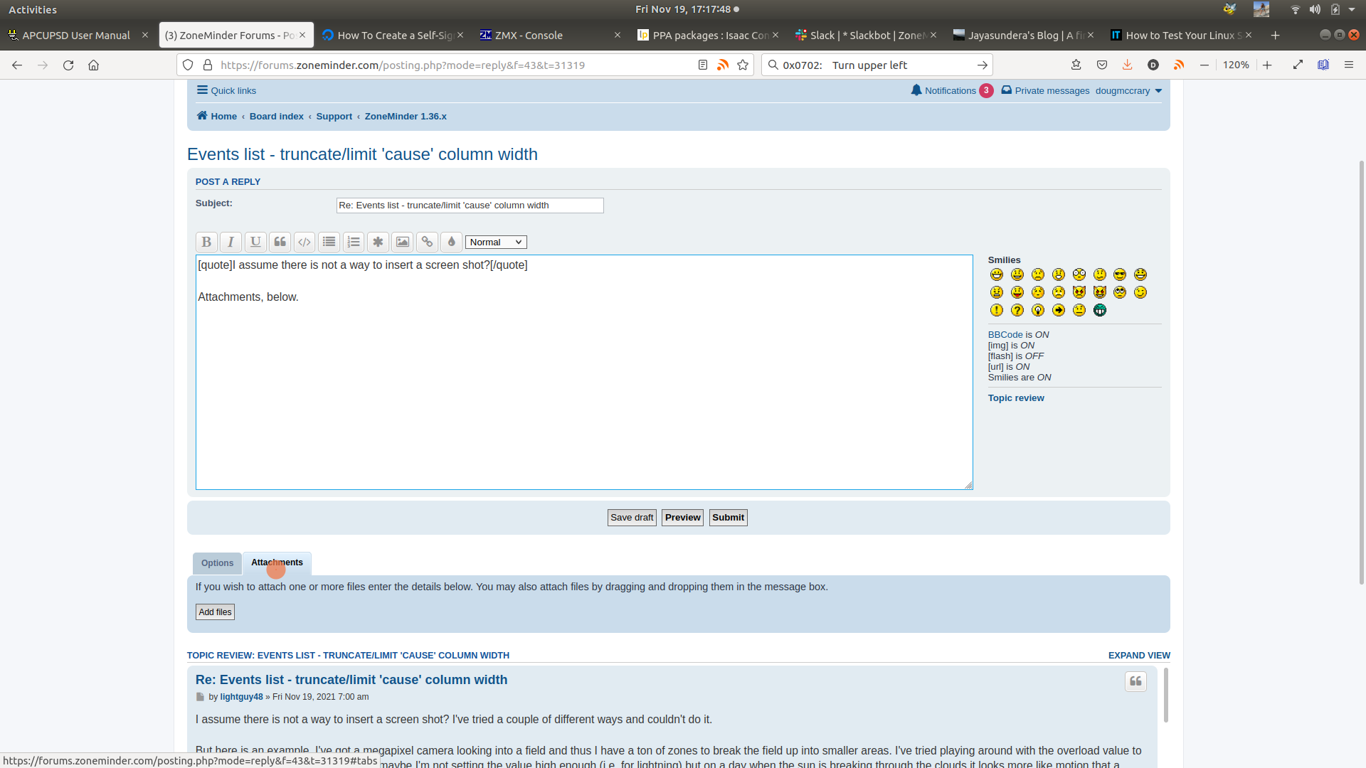

I assume there is not a way to insert a screen shot? I've tried a couple of different ways and couldn't do it.
But here is an example, I've got a megapixel camera looking into a field and thus I have a ton of zones to break the field up into smaller areas. I've tried playing around with the overload value to help prevent this from happening but maybe I'm not setting the value high enough (i.e. for lightning) but on a day when the sun is breaking through the clouds it looks more like motion that a complete overload. (I'm open to any suggestions if you have any)
Attachments, tab below.
Screenshot from 2021-11-19 17-17-48.png (216.85 KiB) Viewed 16526 times
