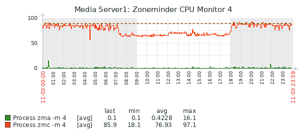

For background, this is the CPU utilization for the system, a low resolution motion detection (Monitor 3, 4 fps, 1024 kbps VBR) and the linked 5MP video (Monitor 4, 8 fps, 6144 kbps)
Zoneminder 1.34, 2 5MP cameras
The decoding of the 5MP video kept a CPU near maximum and the server was limited to two 5MP cameras (a second server was dedicated to the 8MP camera). I tried to upgrade from 1.34.x to 1.36.10, but there was very high CPU iowait time that I could not diagnose; I then opted to apt purge, delete the old videos and drop the database for a fresh install. The results were worth the work.

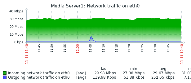

Below are the system CPU utilization and Gigabit Ethernet utilization for all three cameras:
I estimate the Raspberry Pi 4 can handle 8 high resolution cameras operating at or near their maximum frame rates and resolutions.

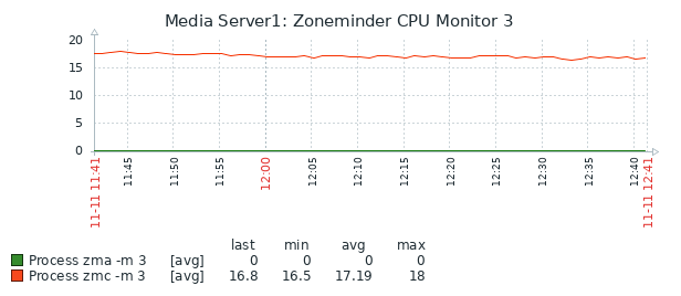

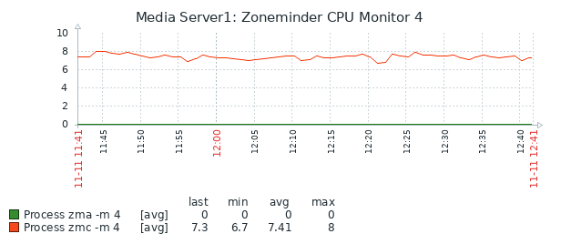

This is the Zoneminder process loads for a 5 MP camera, Monitor 3 is the low resolution motion detection video and Monitor 4 is the high resolution video linked to it with decoding disabled.
