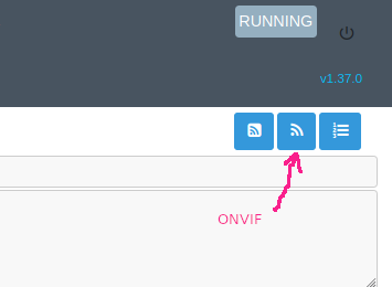

Try this
Source :Ffmpeg
Screenshot from 2021-06-21 23-37-31.png (13.01 KiB) Viewed 13877 times
Press ONVIF button and select the detected camera details & stream , enter the user name and password of the camera . Then save.
You can edit the resolution
