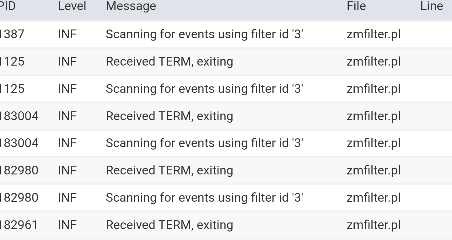

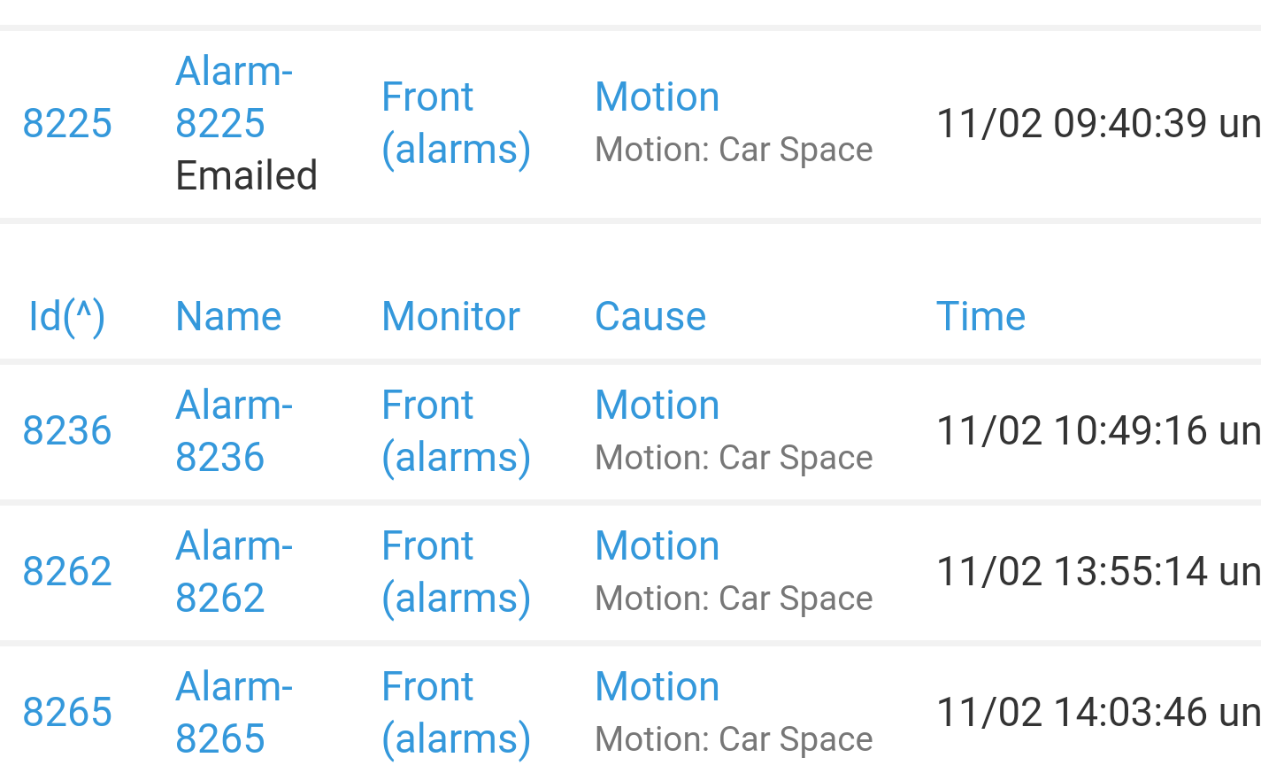

I have a filter set up to send emails on alarms, and until earlier today it's worked perfectly. Now for some reason, it doesn't appear to be doing anything. In the logs I see the filter starting and "scanning for events using filter id 3" then nothing else, when usually it then proceeds to send the emails. If I click list matches, or execute, then I see events in the list without an "emailed" tag...
I've clicked Save a number of times as I know that sometimes kicks things off or restarts the filter, and also restarted the whole box, and nothing.
What's gone wrong?
Filter suddenly stopped sending emails

- Screenshot_20201102-160223.png (122.01 KiB) Viewed 2936 times
- Screenshot_20201102-160149.png (133.63 KiB) Viewed 2936 times

Try running on the commandline and see if you get any useful output.

Do you mean run the same zmfilter command? If so, that's no help :
root@security:/home/andy# zmfilter.pl --filter_id=3
11/02/20 19:36:46.267878 zmfilter_3[3327].INF [main:180] [Scanning for events using filter id '3']
Then it's finished with no more output..

No, doesn't appear to be a deadlock of any kind, the query comes back very quick but with zero results. I've even forced an event and then watched the logs for the minute later and it doesn't come up, still shows zero events found. Yet "list matches" on the filter page shows me all the events fine...

In fact reading that query sql it shows only asking for events before 10am today, yet the filter page has end date time less than 10 seconds ago.. current time here is 9pm. I've restarted the whole machine, at about 4pm, why is that value not updating to be the current time -10 seconds?
- Screenshot_20201102-205615.png (143.81 KiB) Viewed 2917 times

What was strange was the missing "emailed" labels on the list results page. And removing the enddate fields fixed it and I suddenly got a backlog of 50 emails sent to me!
I think for whatever reason the enddate wasn't updating with the correct time in the sql, hence the logs saying the sql said 10am when the time was more like 6pm. Never mind tho, working okay now without either criteria.
