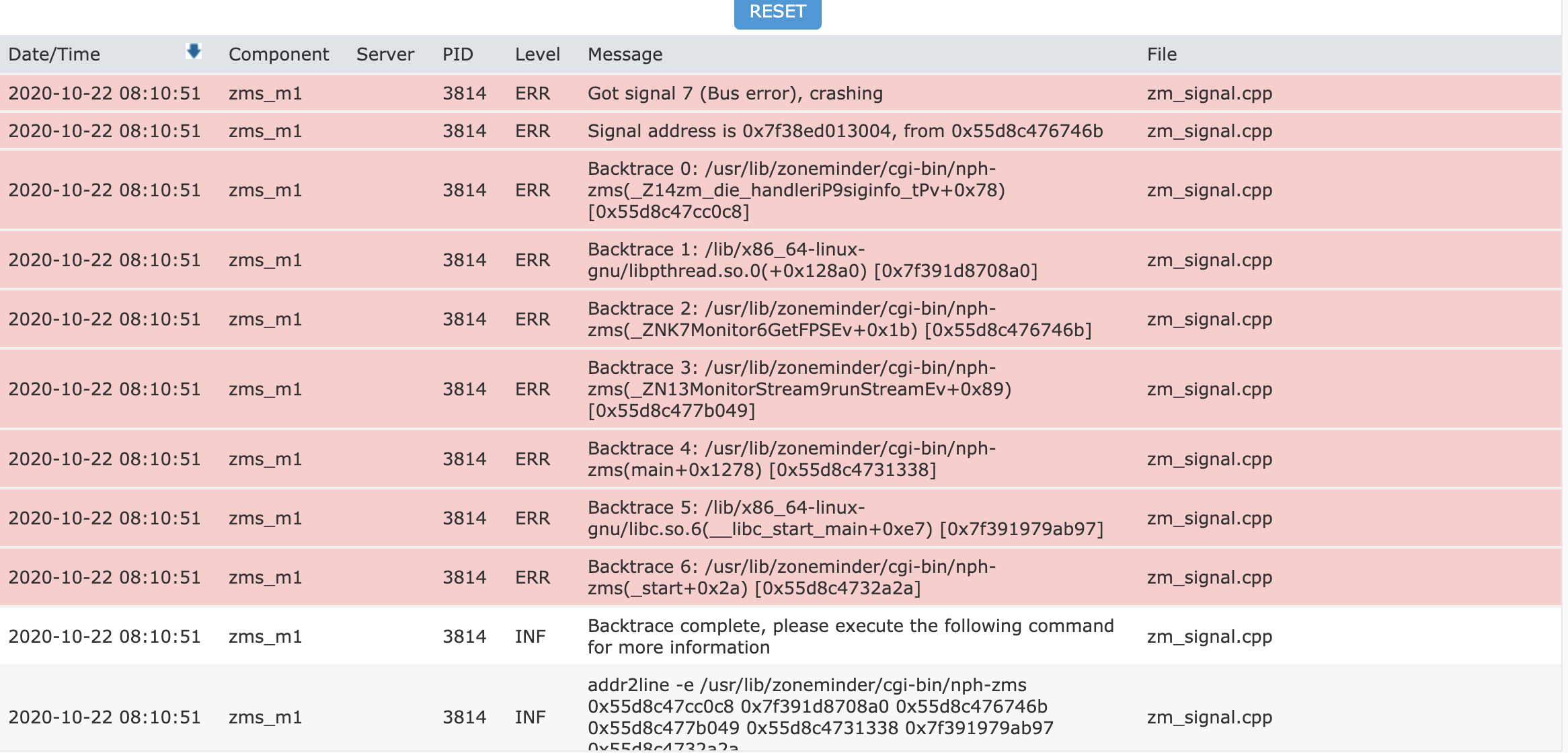

Hi. I don't know what exactly cause this, but it was working fine for a while then started showing these errors. I attached a screenshot and exported log files. Hope someone can help.
zm-log.txt
(97.78 KiB) Downloaded 91 times
Screenshot 2020-10-22 at 08.10.53.png (412.92 KiB) Viewed 1912 times

Is this 1.34.22?

Yes, that's my running version

I've had my doubts about the function where this crash is happening.
However it generally works for me so we need to figure out how to reliably reproduce it.
Can y ou give more information about what is going on when it happens? live view obviously.
Can you turn on debug level 3 logging?
