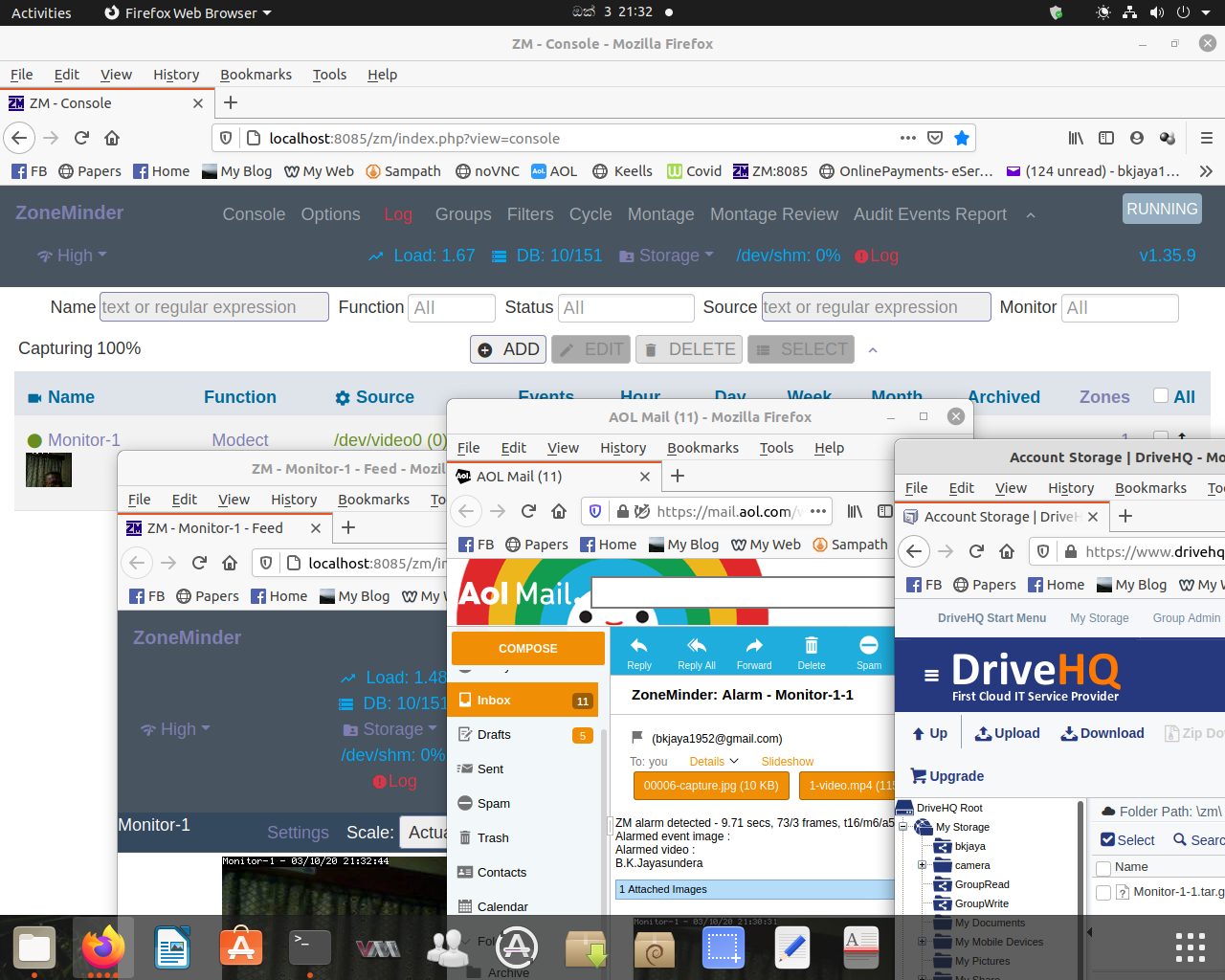

The button for deleting logs in log panel is missing in Zoneminder master 1.35.9~20201003115820-focal released today
Figure:- 1 No problem in creating monitors , emailing , uploading motion detection events
Figure:- 2 Delete Logs button is missing
I had to use the following terminal commands to delete the logs
