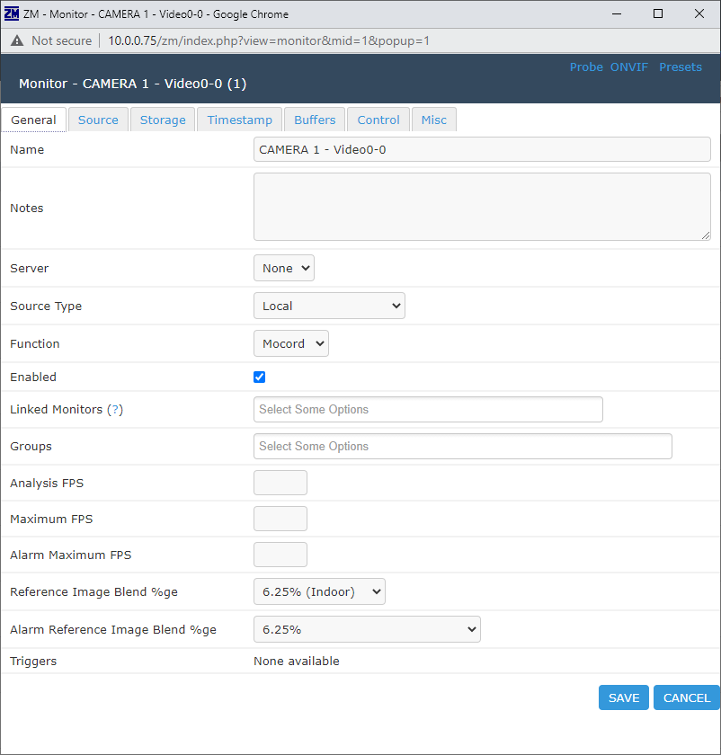

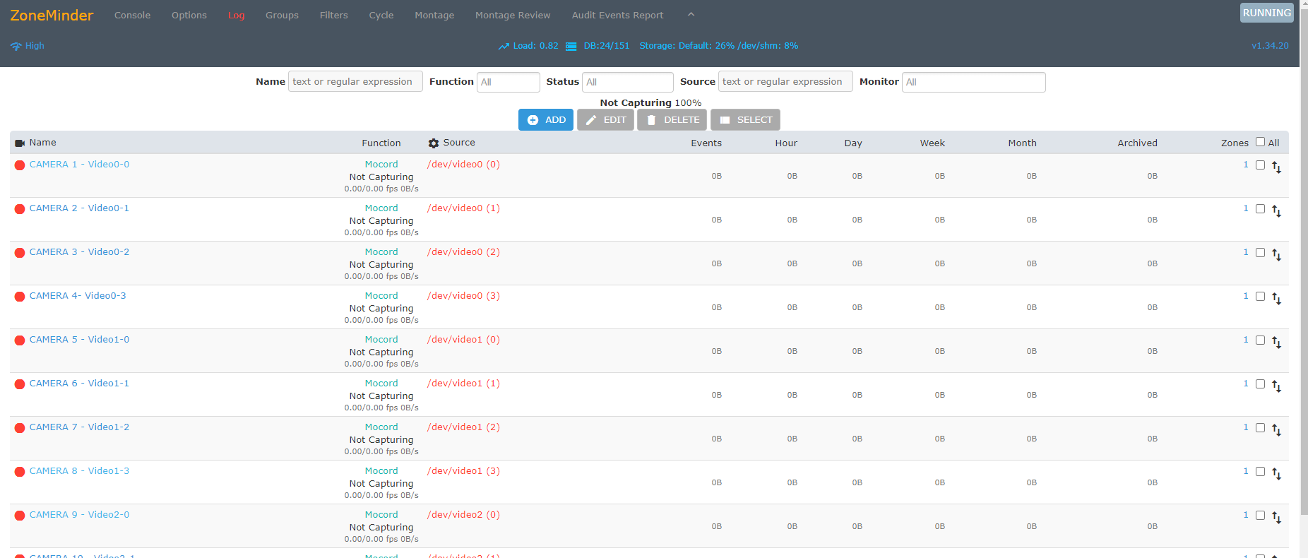

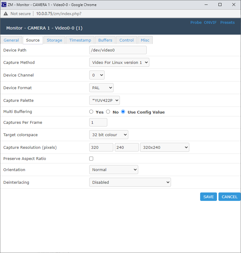

Zoneminder is installed, I used Debian and went with the standard install instructions. Within the WebGUI and SSH'd into Debian, I see the device listed, /dev/video0 through /dev/video3 and the devices have 4 channels a piece. The card has 4x878 chips on it, makes sense so far. The back of the card has 2xDB16 connectors with 8xBNC connections coming out of them apiece. I try plugging a camera into the back of what I would suspect would be channel 1 and I get nothing. I attached pics of my config setup. I have copied the same exact configuration down inside of the webGUI only changing the devices to /dev/video0 through /dev/video3 and then setting up channels 0-3 on each of those devices for a total of 16 channels. Attached a pic of that general setup.
The problem is I cant get a signal from a camera. I try to use the probes and I dont see any cameras when I have one connected into what seems like any port. I am currently connecting a single BNC camera into each port to see if I can get anything from any port. It feels like I am super close and maybe I just have some sort of weird configuration error, which is why I am here. Below is the output from the zmu command which I've seen requested a lot. I am trying to give as much info as I can, and it would be amazing if anyone could help me with this. Thank you.

/dev/video0-3 channels 0-3 setup
ZM setup.png (54.08 KiB) Viewed 14923 times
source setup.png (27.06 KiB) Viewed 14923 times

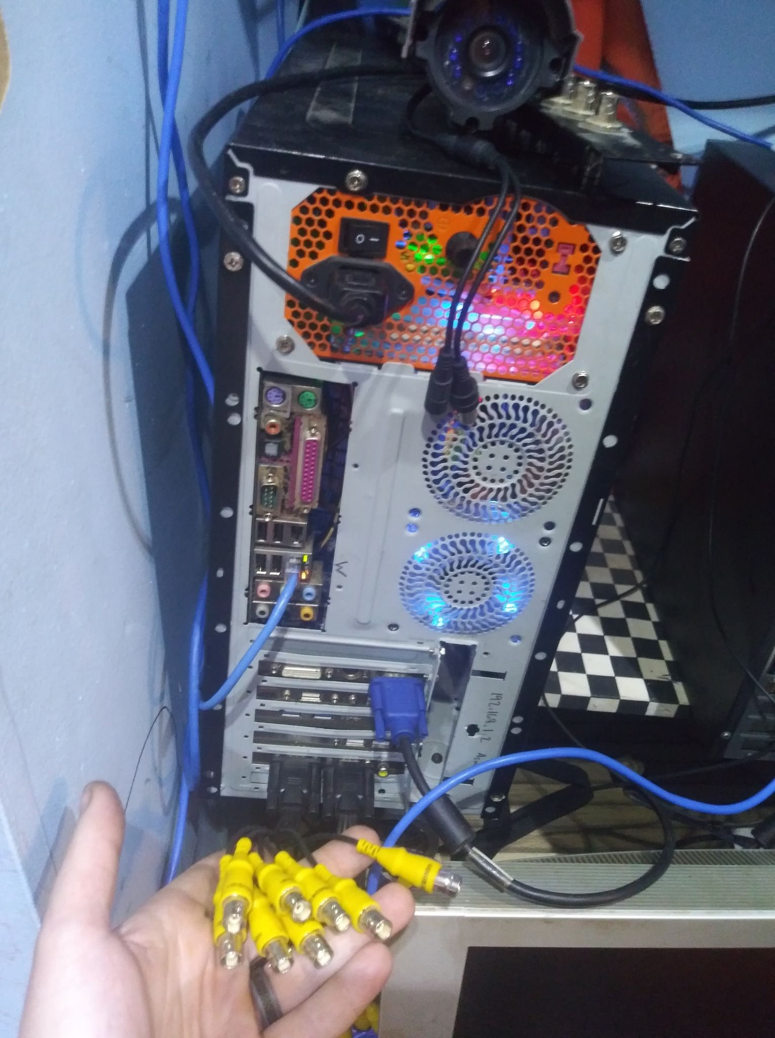

Thank you both for your replies. I have basically tried what you suggested @mikb. I took a BNC wired camera, plugged it into power, the NV LEDS came on, I plugged it into each channel on the back of the card, would go to my laptop and refresh my status page on zoneminder a couple times, and I wouldn't see anything. I have each channel configured (I think) check the pics in my first post.
pics
pics
inputs on card.jpg (297.11 KiB) Viewed 14859 times
