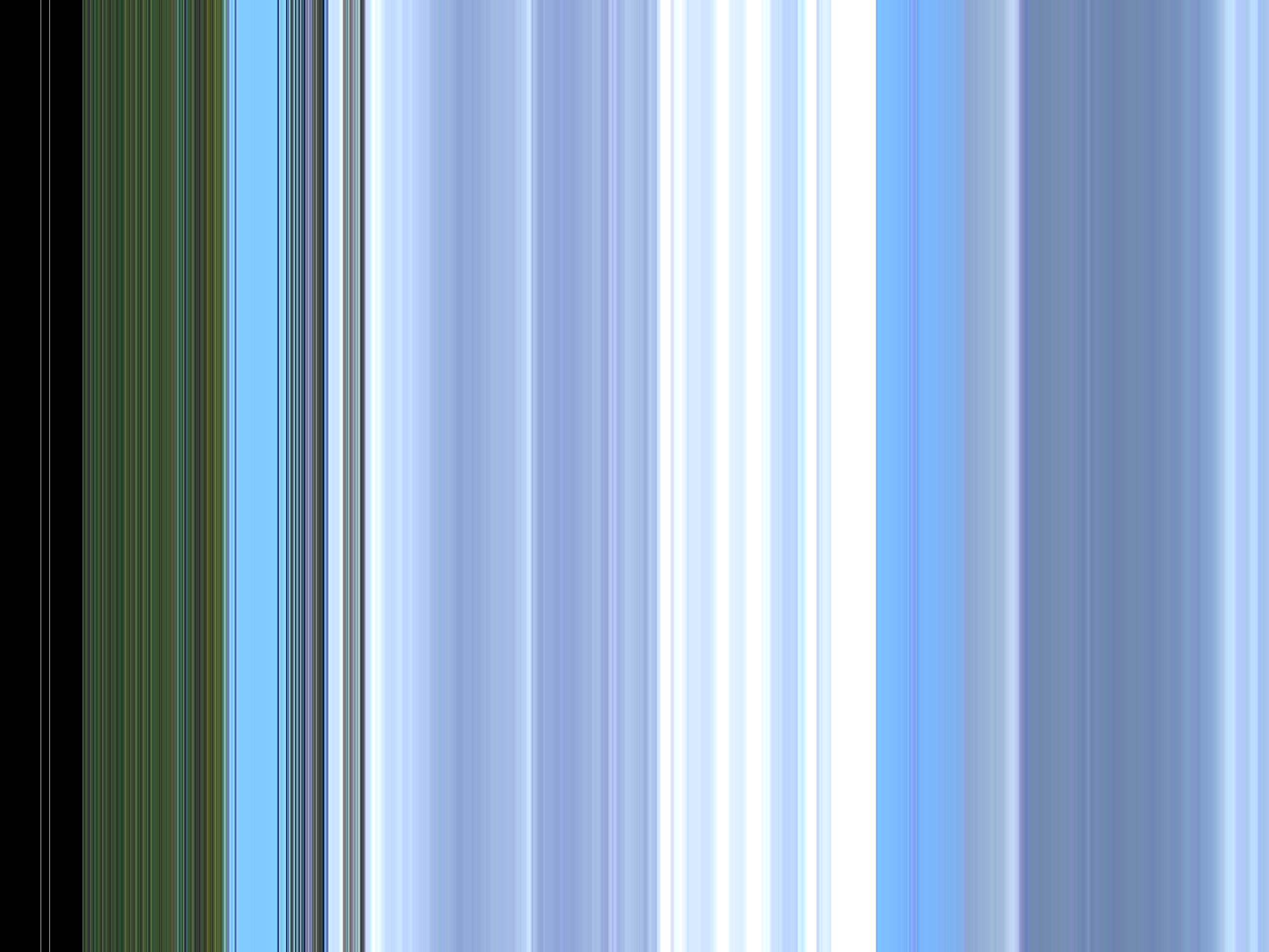

Alarmframes (*-analyse.jpg) broken since 1.35.5~20200716162846-bionic
Post by tomcat84 »
Hi, since the last Update to 1.35.5~20200716162846-bionic all my Alarmframes (*-analyse.jpg) looks like the picture attached if I click on them.
If I click behind or before the frame I see them using PREV / NEXT but the detected area is not longer marked.
Any Ideas whats the reason for this problem ?

Posts: 3363
Re: Alarmframes (*-analyse.jpg) broken since 1.35.5~20200716162846-bionic
Please try today's image. I think I fixed this a few days ago

I'm still seeing this problem with 1.35.5~20200721160555-bionic.

same here.
Posts: 3363
I think I have it fixed. Building new packages now.
