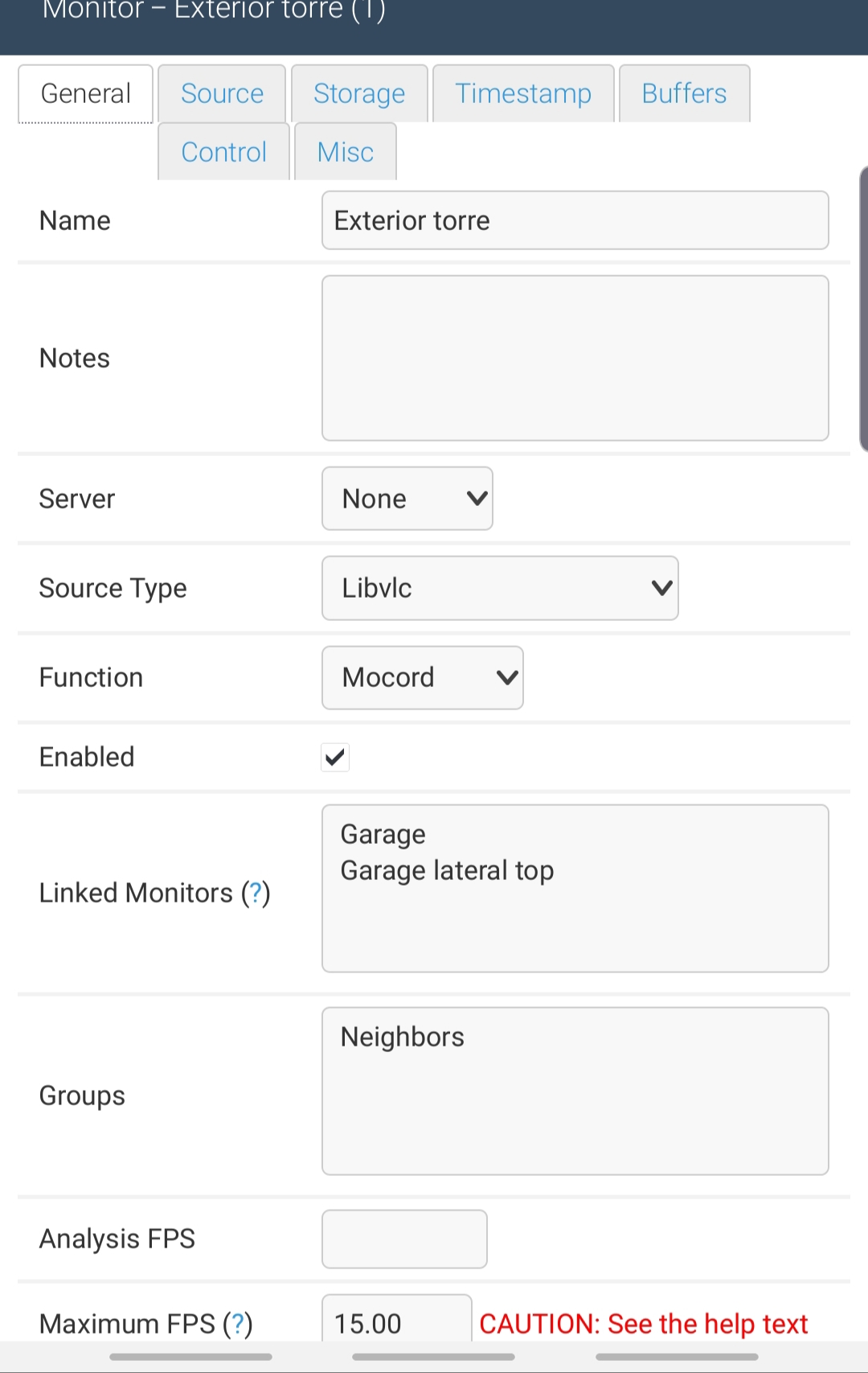

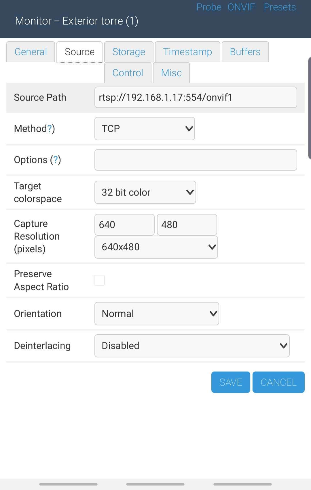

You need rtsp://192.168.1.17:554/onvif1
I have several Siricam good price specifically the SP007 with metal case. Resolution is up to your server is maximum 1280
Look the 2 attach files .
