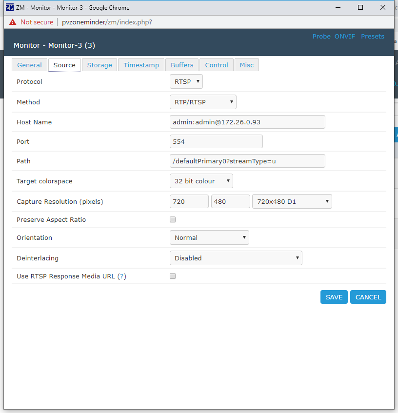

I have a number of analog cameras I am trying to add to my existing ZoneMinder setup so I got a Avigilon 4 port video server.
It work great with the Avigilon camera tool, it even tells you the rtsp string.
I can connect to it just fine with ffmp
ffmpeg -i rtsp://admin:admin@172.26.0.93:554/defaultPrimary0?streamType=u output.avi
But cannot seem to get ZM to see it. I have it setup just like my other WiFi cameras and I've tried all sorts of settings but no luck. Hints on where to go from here?
Screenshot 2020-04-21 20.54.10.png (38.53 KiB) Viewed 3030 times

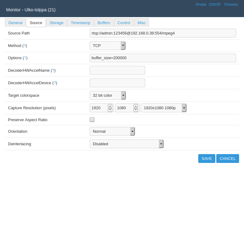

If you can access the cameras using ffmpeg why you do not use it for Source Type?
And then Source like this:
Screenshot_2020-04-23 ZM - Monitor - Ulko-tolppa.png (40.08 KiB) Viewed 3007 times
Works fine for me with rtsp-cameras.
- TRa
