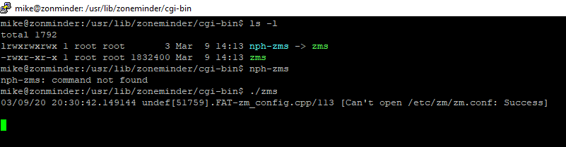

zma is not zms.
Try /usr/lib/zoneminder/cgi-bin/nph-zms
OldTImer37
Posts: 11
Joined: Tue Mar 10, 2020 12:20 am
Re: Errors - not sure why

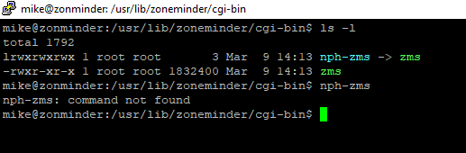

Post by OldTImer37 »
I get
nph-zms: command not found
Bluemax
Posts: 140
Joined: Wed Jun 12, 2019 5:15 pm
Post by Bluemax »
Either type this (absolute path):
/usr/lib/zoneminder/cgi-bin/zms
or if you are in the folder (as on the screenshot) you can use this:
./zms
If you just type the pure command name (as you did) it looks for the file in the $PATH folders only ('echo $PATH' to check).
OldTImer37
Posts: 11
Did that - needed to hit ctrl-c to break out of the program

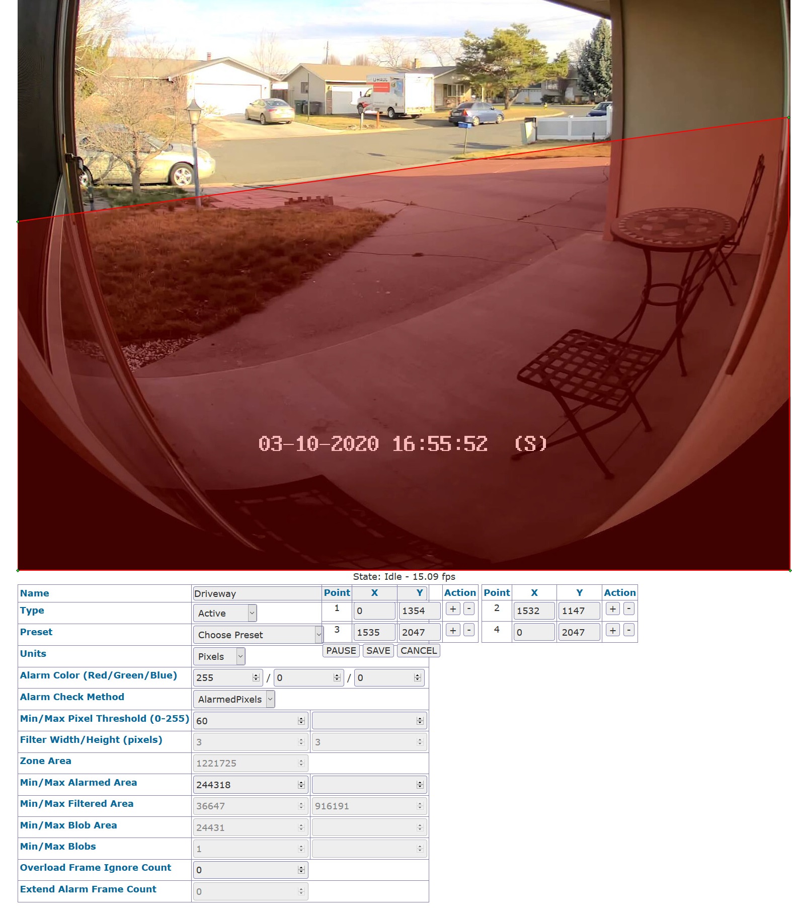

OldTImer37
Posts: 11
Here are the existing settings (cropped for smaller size)
I have had it detect some motion once I manually type in
zma -m 1 but the clips are only 5-6 seconds.
Screenshot_2020-03-10 ZM - Zone.jpg (502.09 KiB) Viewed 9633 times
