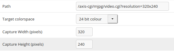

i have same problem, but currently not really solve.
u can change setting on "Source" column, n then on tab Source change base on your camera,
below is example base on my camera
zonminder fixing error.png (13.38 KiB) Viewed 5510 times
