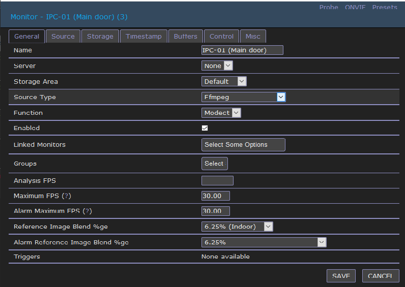

Create a new monitor and configure it like this:
Change "Name" and "Function" as you like
For the "Maximum FPS" and "Alarm maximum FPS" i guess you should leave the default values you have (this can cause problems as far as i know)

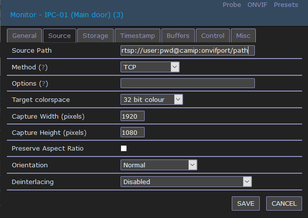

Move to the "Source" tab and configure it:
"Source path" is the key. build it up like this:
rtsp://USER:PWD@CAMERAIPADDRESS:ONVIFPORT/PATH
for example:
rtsp://admin:123456@192.168.1.1:81/ucast/11
You should be able to get all the information you need from ONVIF Manager.
Check the width and height of your streaming video and put the exact values in the "Capture Width (pixel)" and "Capture Height (pixel)" fields.
Save it and see what happens.
