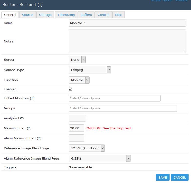

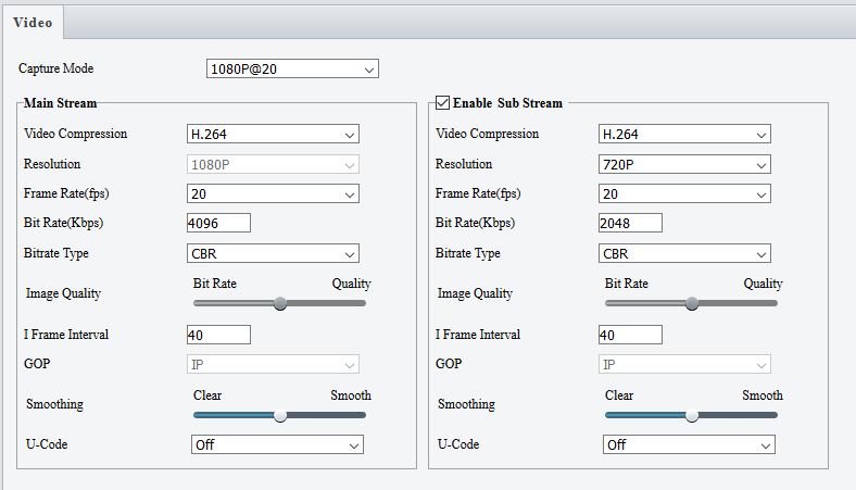

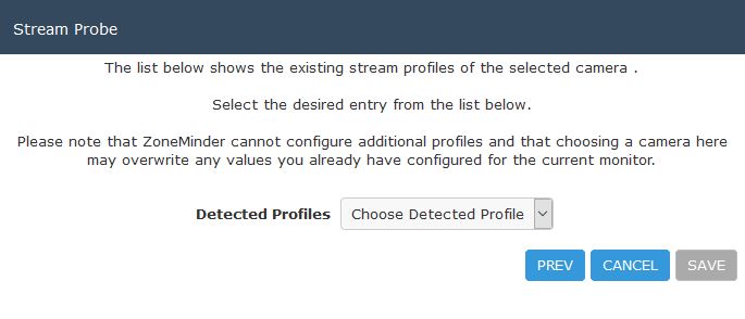

hello
iam trying to add my UNV IPC2125 OnVIF camera
it appears in detected cameras list
but after selecting no profile is detected
iam trying to add it manually
i can view camera on player with link:
rtsp://admin:123456@192.168.1.6:554
i have no experience with zoneminder
version is: 1.33.16
camera settings:
Last edited by mahmoudalattar on Wed Jan 01, 2020 7:05 am, edited 1 time in total.

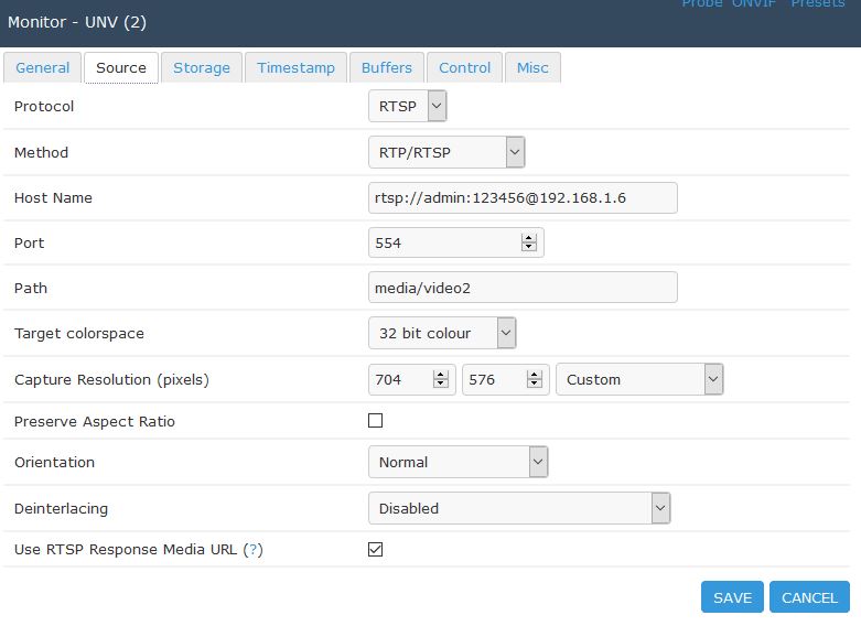

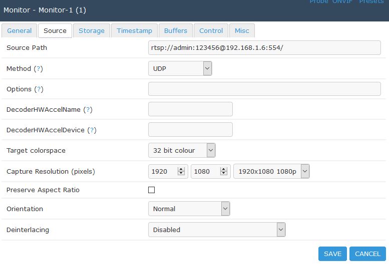

i tried these manual configuration but also not connected
zm setting 1.JPG (61.58 KiB) Viewed 7802 times
zm setting 2.JPG (53.24 KiB) Viewed 7802 times
snake
Posts: 337
Re: peoblem while Adding OnVif camera
Post by snake »
Remove max FPS on zoneminder. Leave blank.
Change method to TCP.
You can use FFMPEG or LibVLC for rtsp.
Test in ffmpeg from command line, to get resolution and confirm it works.
See https://wiki.zoneminder.com/Finding_Camera_Stream_Paths
If you are on RPI, lower FPS on camera.
