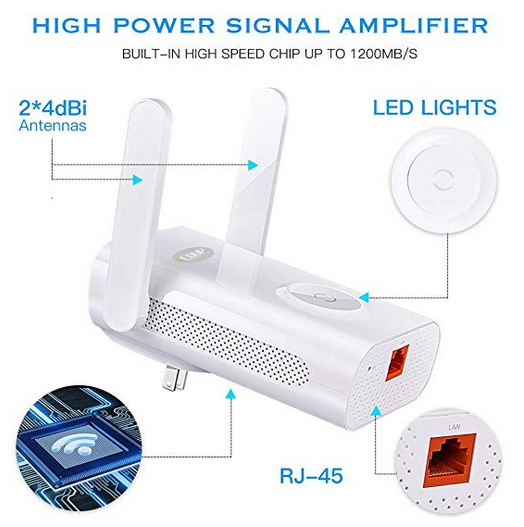

I have a wired, weatherproof POE camera from SV3C that I'd actually like to connect over wifi.
This camera will be mounted outside my home about 50 feet away. What I'd like to do is run the Ethernet cable to my home and then (hopefully) plug it into a wifi extender/booster so it can connect over wifi.
It seems that a lot of Ethernet extenders have an Ethernet jack on the bottom that can be used to connect non-wifi devices. I'm thinking of something like this device: https://www.amazon.com/gp/product/B07J44FS8L . See the picture below.
(I have a POE injector/splitter to power the camera, one end to the camera, the other end will go to the LAN connector.)
I haven't tried this yet, but is there any reason I couldn't plug the cable from the camera into the LAN jack on the bottom of the wifi extender and then connect it to Zoneminder over wifi?

I haven't been able to get this to work yet; I'm unsure how to tell what the IP is of the camera that's plugged into the ethernet extender/bridge. Nothing I've tried yet seems to connect.
Posts: 2976
Re: Connecting wired ethernet camera via wifi
Many of the WIFI extenders have an ethernet port that is used to configure the device. Once parted from the cable the port does not serve as a cable connection through the WIFI. I have a Linksys RE4000W extender that will provide connection through its ethernet ports. If you use an old router look up to configure it as a media bridge. You will get better through put as a media bridge than a WIFI repeater.

bbunge wrote: Fri May 31, 2019 11:51 am Many of the WIFI extenders have an ethernet port that is used to configure the device.
Thanks bbunge.
The one I have (https://www.amazon.com/gp/product/B00R92CL5E/) does have a port on the bottom that's supposed to be able to serve as a wifi bridge. I'll have another go at it this weekend and see if I can get it to be recognized or connected.
bbunge wrote: Fri May 31, 2019 11:51 am If you use an old router look up to configure it as a media bridge. You will get better through put as a media bridge than a WIFI repeater.
