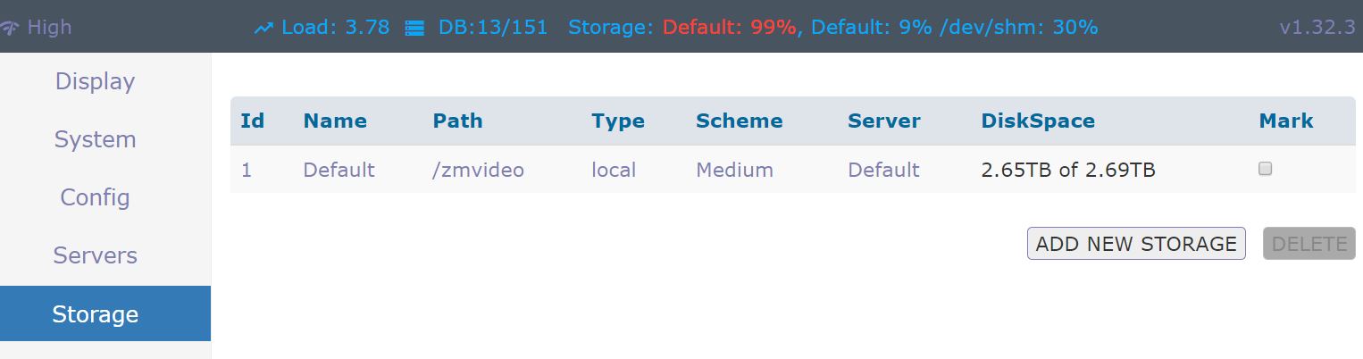

After a clean Ubuntu 18.04 install and ZM 1.32.3 install I have filled my data disk. The Purge when full filter returns no results.
I have 2 HDs, 1 OS and programs and 1 Video only. The console page show 3TB (video drive) at 99% and Default at 9%. Testing tends to indicate that those numbers are put together for the purge filter. If I set the filter to 10% it returns results.
Default is not defined and I do not know how to remove it.
Where should I look to either make the Purge work per storage area or to remove Default?
Thank you

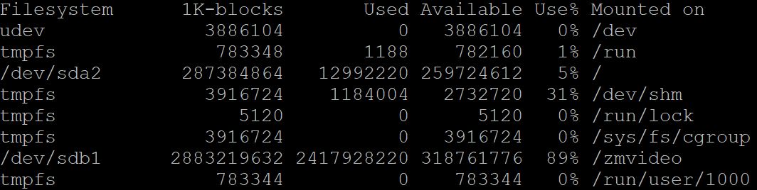

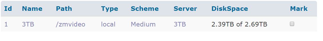

Further information:
Using the "Disk Blocks" filter "Greater than or equal" I have confirmed that it is retrieving only the usage of "/" not of "/zmvideo" When I use the Used block number the filter returns events. If I change the number to less blocks it returns no events.
What did I set wrong?
Is there any other information I need to share?

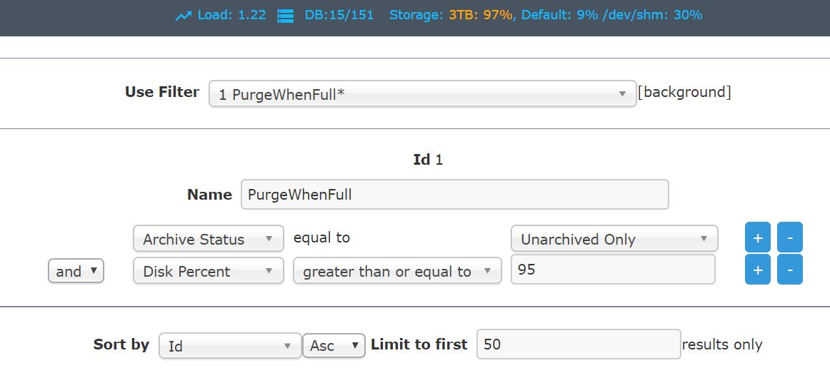

Re: PurgeWhenFull not working
Excellent suggestion, but unfortunately not the answer.
Thank you,
Screenshot with the typo.
Thank you,

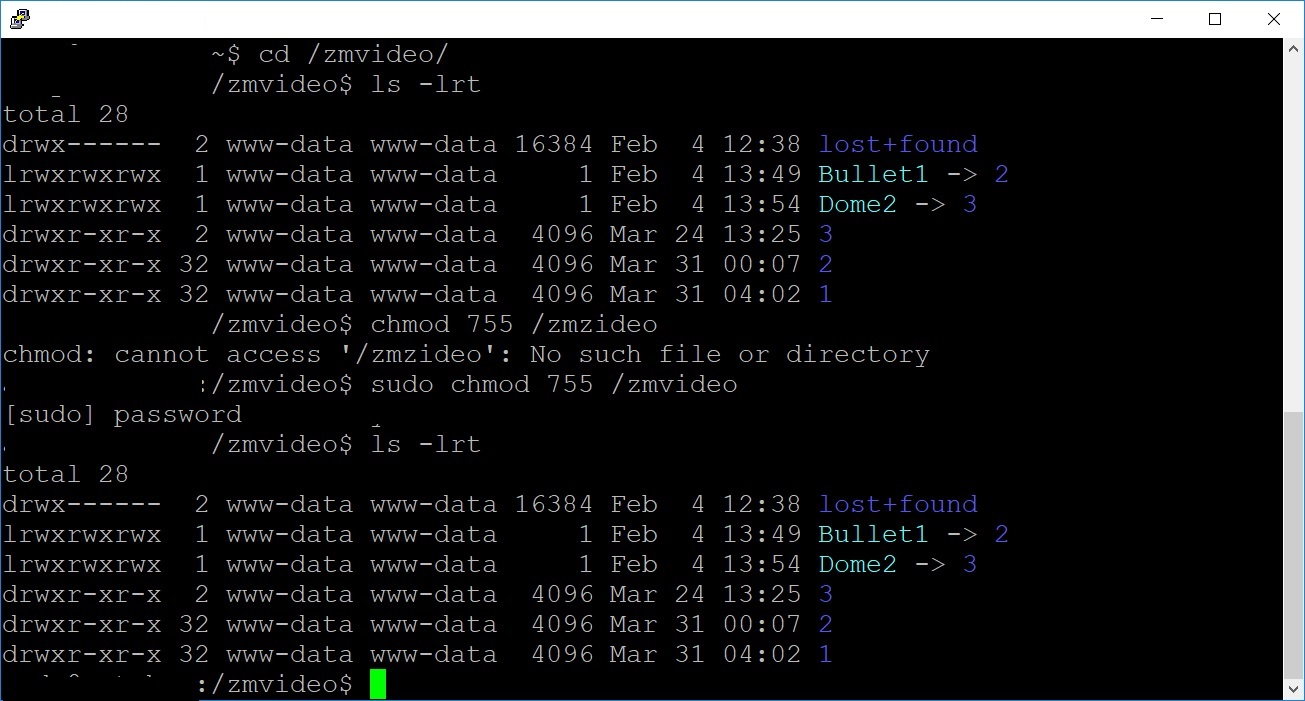

I wouldn't expect to see the permissions of the files and folders under /zoneminder change after the chmod though, just the directory itself, but maybe chmod-ing the entire tree would work?
I, too, use a separate drive for ZM, but I didn't do it according to any of the HowTos or by altering storage paths within ZM - I mounted the drive elsewhere and then used 'mount --bind' to make it appear as ZM's default storage, something like this...
If you want to retain access to any existing files in /var/lib/zoneminder then you'll need to copy them to the mounted drive first.
mount --bind /zmvideo /var/lib/zoneminder

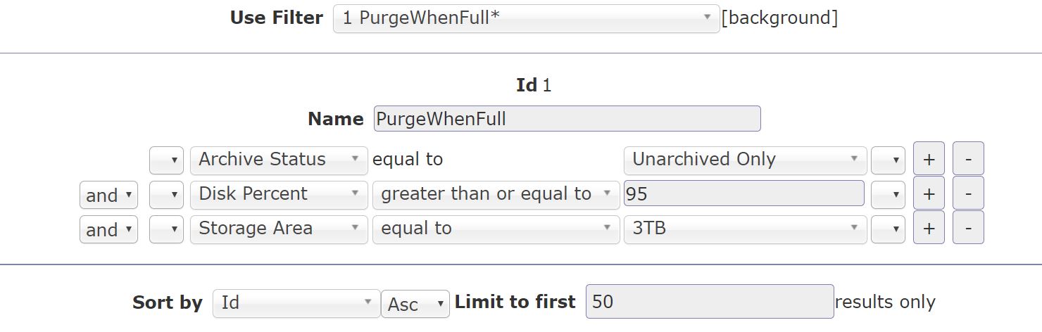

I solved the problem. The PurgeWhenFull default rule does not account for Storage Areas. I added a condition and it now returns what it should.
