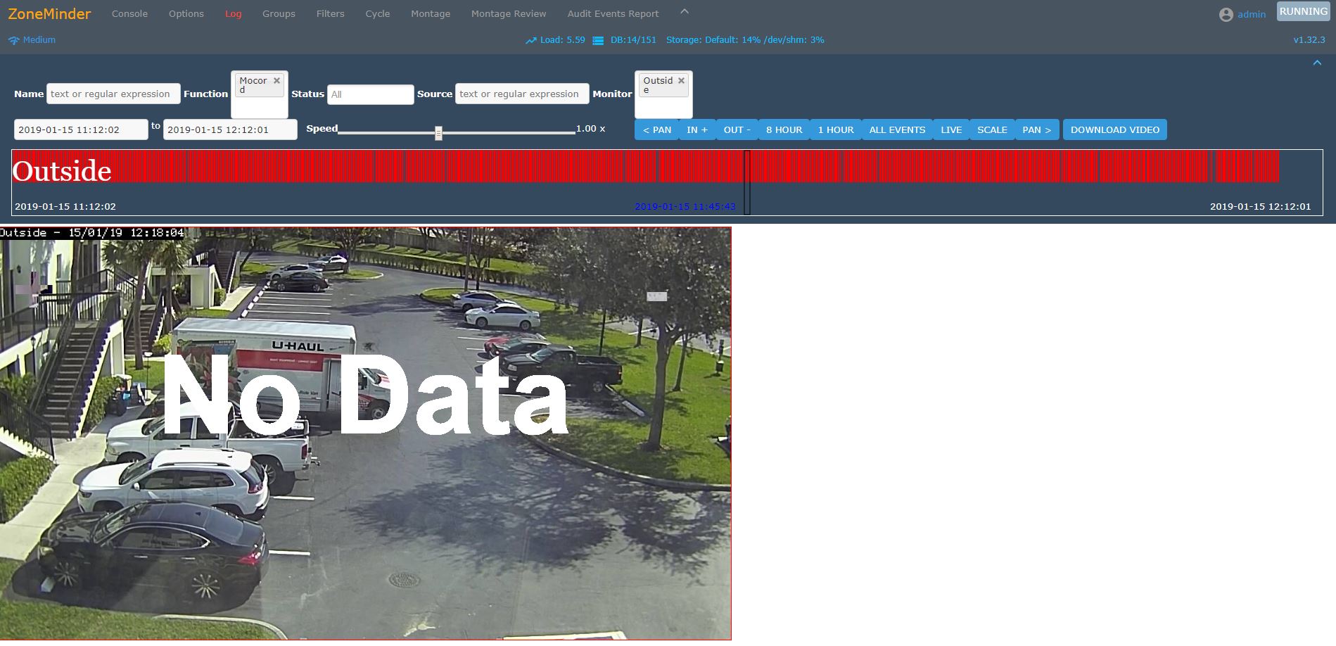

I have the following installation:
Zoneminder: v1.32.3
OS: CentOS Linux release 7.6.1810
Installed via:
- sudo yum localinstall --nogpgcheck https://download1.rpmfusion.org/free/el ... noarch.rpm https://download1.rpmfusion.org/nonfree ... noarch.rpm
- yum install zoneminder
Cameras: Foscam FI9821p V3 (latest firmware - same firmware used with zoneminder 1.28)
Coming from version 1.28, instead of upgrade, I decided to do a fresh installed. (I didn't have much configured in 1.28 and 3 cameras only)
Everything is working as expected except the Montage Review.
Montage Review always shows "No Data" in the stream.
I've checked the system, php and DB timezone and time and they all match.

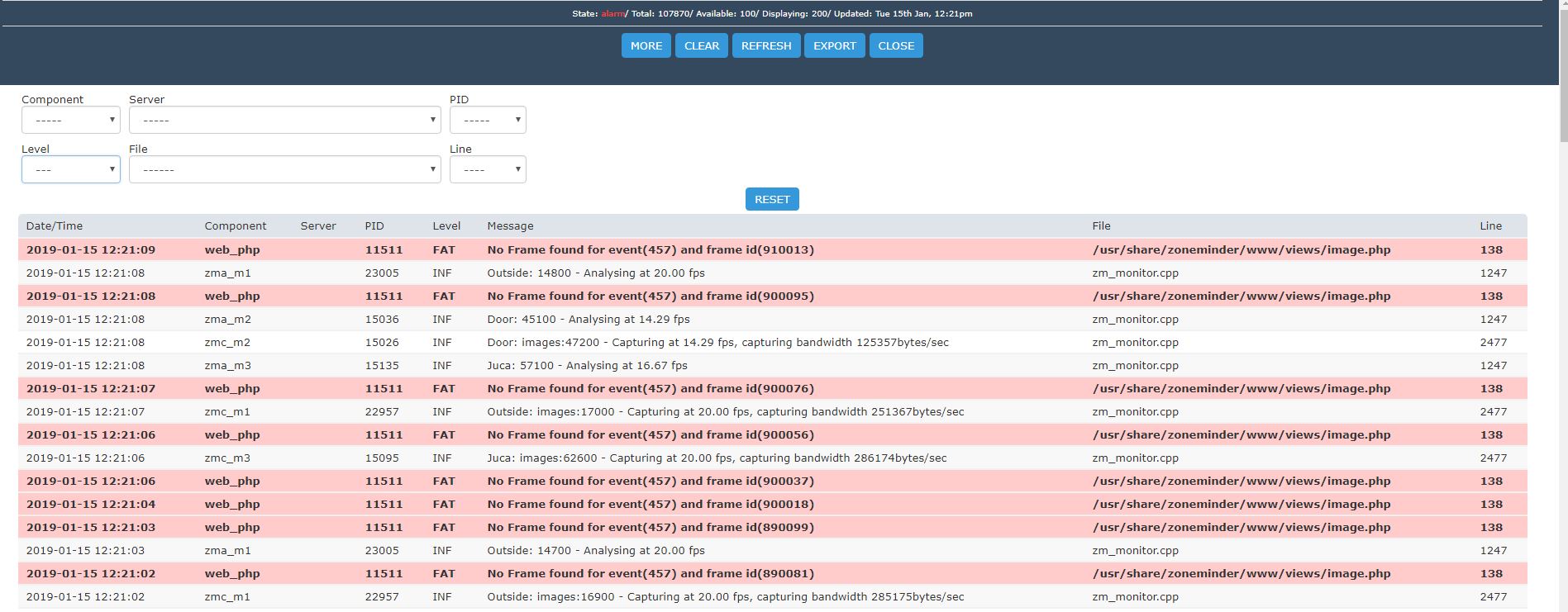

In the Logs, I received the following warning:
2019-01-15 12:19:10 web_php 11501 FAT No Frame found for event(457) and frame id(690054) /usr/share/zoneminder/www/views/image.php 138
2019-01-15 12:19:09 web_php 11501 FAT No Frame found for event(457) and frame id(690035) /usr/share/zoneminder/www/views/image.php 138
2019-01-15 12:19:08 web_php 11501 FAT No Frame found for event(457) and frame id(690017) /usr/share/zoneminder/www/views/image.php 138
Attached are two screenshots, one with the "No Data" in Montage Review and the second of the logs when accessing Montage Review
Has anybody experienced something similar? And if so, any fix?
Thank you.

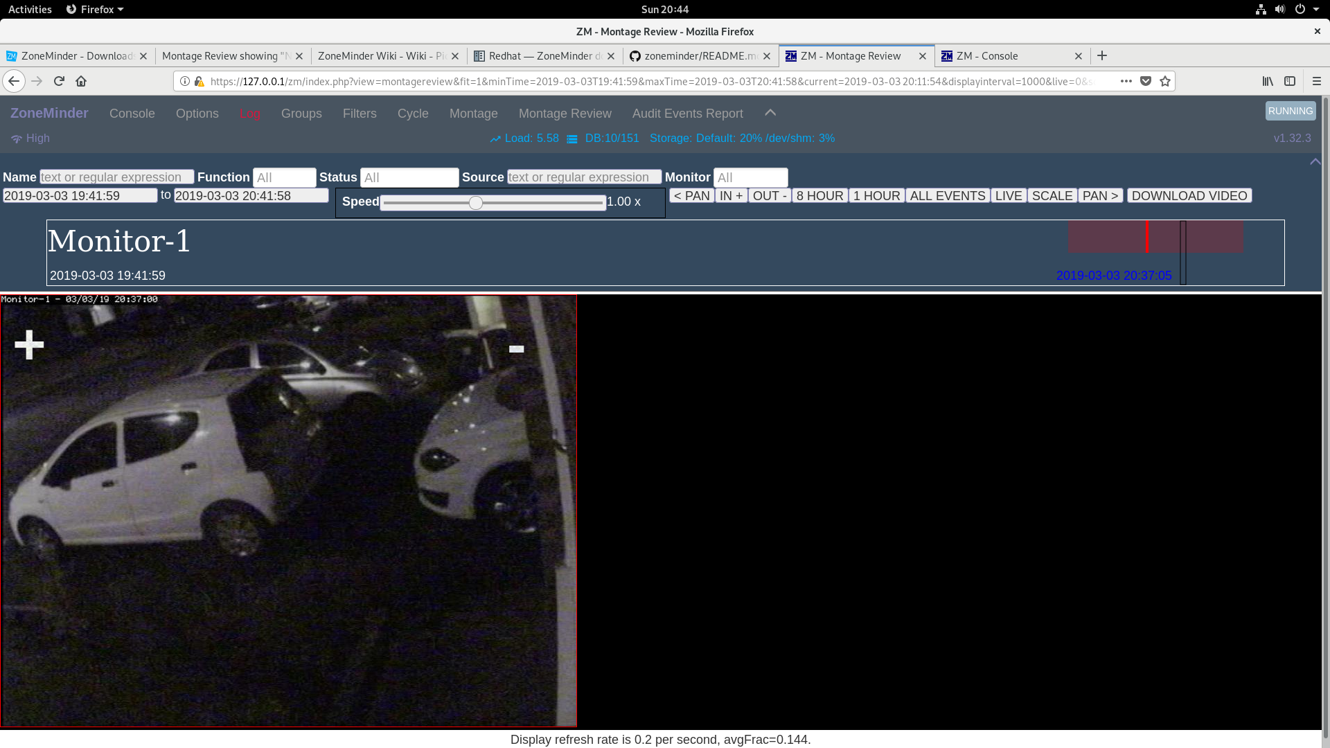

Update 3-2-2019
Fedora 29
Zoneminder 1.32.3
Performed a clean install of Fedora 29 and the Montage Review function is working and most other functions of Zoneminder seem to work.
I'll test over night and then use a different storage location for the media as a further test and report back
It would appear there is a problem with the current current RPM Fusion build and CentOS 7.5
Update 9-3-2019
Alternative storage drive tested and works perfect
All functions of ZM seem to be working OK
Conclusion there is an issue with a package used by ZM on CentOS 7.5
Screenshot from 2019-03-03 20-44-01.png (851.58 KiB) Viewed 52855 times

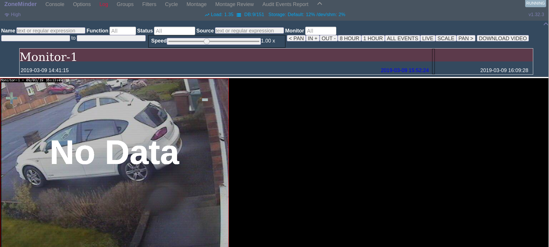

Update.
Fresh Install of CentOS 7.5
Install Zoneminder 1.32.3 without updating CentOS
No modifications or custom settings install, pure fresh out the box CentOS and ZM
Same No Data Error
update CentOS via Yum
Same No Data Error

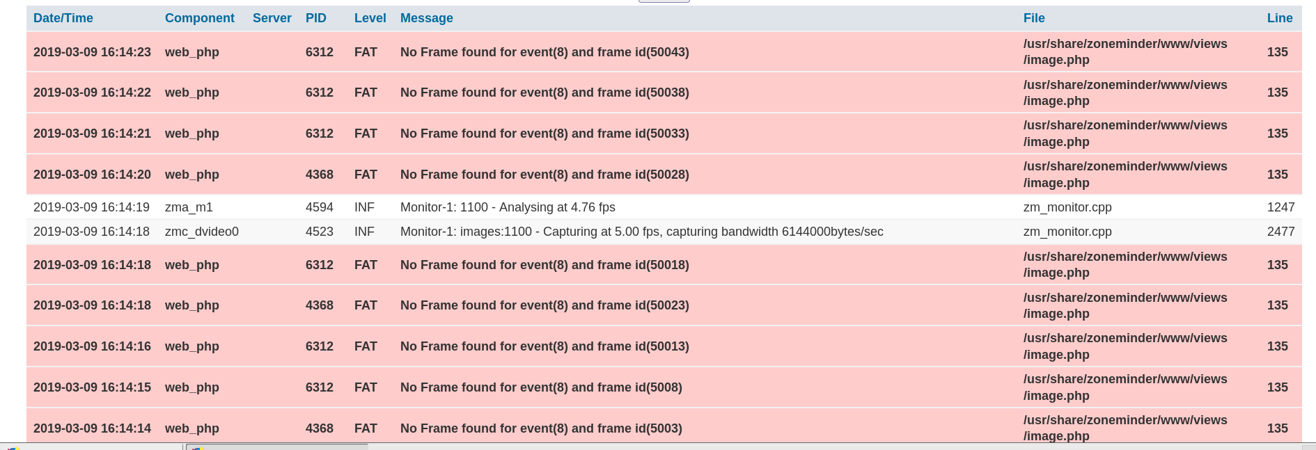

And the log has lots of the following errors
2019-03-09 16:14:37 web_php 6312 FAT No Frame found for event(8) and frame id(6003) /usr/share/zoneminder/www/views/image.php 135
Beyond building ZM from source I'm lost now
update.
upgraded to 1.33.1 testing and the Montage Review is working but not fully it will scroll through the time line but will not playback.
ZMrepo installed the below additional packages so it might be an issue with the old packages that is causing the problems.
Package Arch Version Repository Size
Updating:
libdca x86_64 0.0.5-9.el7.centos zmrepo 101 k
perl-Class-Std-Fast noarch 0.0.8-2.el7.centos zmrepo 23 k
perl-IO-Interface x86_64 1.05-15.el7.centos zmrepo 28 k
xvidcore x86_64 1.3.4-2.el7.centos zmrepo 263 k
zoneminder x86_64 1.33.1-1.134.20190209gitg2dc935b48.el7.centos zmrepo-testing 14 k
zoneminder-common x86_64 1.33.1-1.134.20190209gitg2dc935b48.el7.centos zmrepo-testing 8.7 M
zoneminder-httpd x86_64 1.33.1-1.134.20190209gitg2dc935b48.el7.centos zmrepo-testing 19 k
Transaction Summary
Screenshot from 2019-03-09 16-15-02.png (630.16 KiB) Viewed 52784 times
Screenshot from 2019-03-09 16-14-26.png (151.5 KiB) Viewed 52784 times

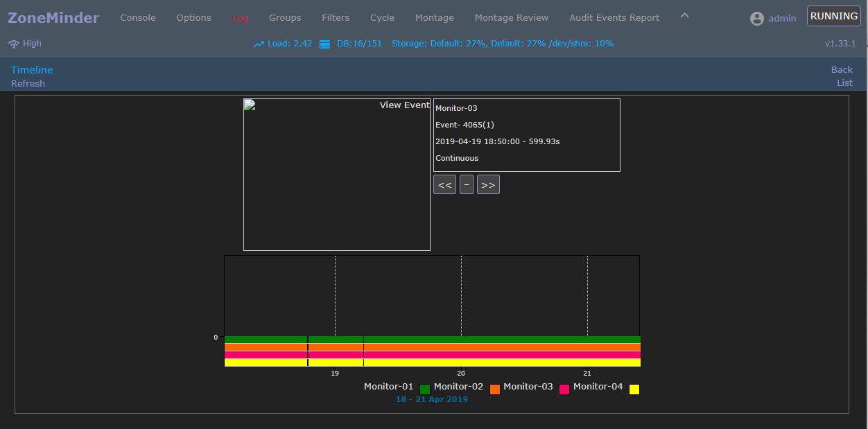

zoneminder 1.33.1
centos 7
show timeline
2019-04-21 10:25:27 web_php 15447 ERR Capture file does not exist at /var/lib/zoneminder/events/2/2019-04-21/4899/00001-capture.jpg /usr/share/zoneminder/www/includes/Event.php 415
2019-04-21 10:25:27 web_php 15447 FAT No Frame found for event(4899) and frame id(1) /usr/share/zoneminder/www/views/image.php 149
frame id is always 1
where the picture was initially displayed
