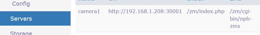

added the ports in /etc/apache2/sites-enabled/000-default.conf:
<VirtualHost *:80 *:30001 *:30002 *:30003 *:30004 ....... and so on
in the options for all the ports added related server like:
