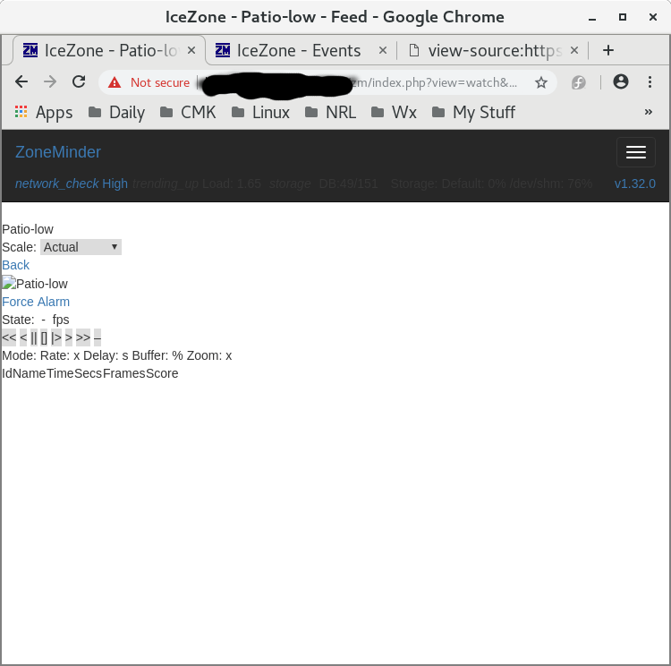

This morning my zm setup got updated via yum and I've lost access to all my monitors. Can't view any of the defined monitors. The events that are showing can't be viewed as well, they also can't be deleted. I'm betting I just need to refresh something in the setup but it's eluding me at the moment. I'm running on Scientific Linux 7.5, which is up to date for all packages. I get the zoneminder package via rpmfusion-free. The attached screenshot is one of my monitors, no display at all and that's what I get for every monitor. Similar results when trying to view events.

Hello ! looks like a minor problem.....make sure the new zoneminder.conf is enabled for Apache
a2enconf zoneminder
restart Apache
the CSS is not being accessed so the page is displaying incompletely ...the alias or symlink for /usr/share/zoneminder/www/cache is missing and probably not configured...hence the new zoneminder.conf

Read through /usr/share/doc/zoneminder-1.23.0/README.
It does not mention needing to move /etc/zm/www/zoneminder.conf into /etc/httpd/conf.d/ so apache can read it upon startup. Once I copied that file over things started looking much better.
