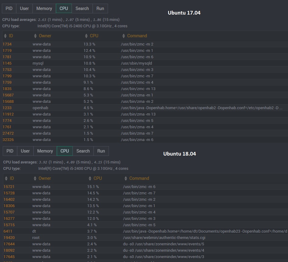

I spent the weekend upgrading Ubuntu 17.04 now quite long out of support to 18.04 LTS. To give myself time and ease of rollback, I grabbed a new SSD and started fresh knowing I can plug in the former build and get the server is back online.
So I followed the wiki https://wiki.zoneminder.com/Shell_scrip ... all-bionic which worked a treat. Thanks for that!
After standing everything up on the same hardware, DB restore, config and everything is mirrored, sits at double it's former utilisation. Both installs are ZM 1.30.4
Ubuntu 17.04 CPU Load Around 2.0 doing it's all cams Mocord normal run
Ubuntu 18.04 CPU Load Around 4.0-4.5
Both measurements are after a few hours so the server is "settled" doing it's thing. I've since rolled back to the 17.04 SSD so I can troubleshoot.
The only differences are the 17.04 was actually a Desktop build, I kept the 18.04 to the server only and only installed the dependencies as I wanted to keep it trim... Both were running an OpenHab instance also, but it runs pretty light.
If anyone can give me some starting points to look at the camera streams themselves, I can see it's all across the ZMC's and all are just a 2%ish higher
Nothing obvious in the logs... if I didn't know it normally ran at half the utilisation I'd think it was a healthy build (aside from over utilising the 4 available cores...)
Any suggestions appreciated
Cheers!

- snips.jpg (166.37 KiB) Viewed 5425 times

I'm assuming you upgraded the same PC/server to 18.04 - so, no hardware changes (other than the SSD).
So, according to this: https://blog.ubuntu.com/2018/01/12/melt ... tus-update , 17.04's kernel never got any of the Spectre or Meltdown mitigations. However, 18.04 does have all the mitigations. The mitigations result in a big hit on performance and especially related to I/O (eg: disk, net, I/O related to buffers/caches in memory, etc.). The performance hit varies from case to case, but in general a hit of 20-30% is common. High I/O apps (like zoneminder) can take a bigger hit than that. Really depends on the app and CPU. At the moment, AMD CPUs (in general) only need mitigations for Spectre. However, Intel CPUs (in general), need mitigations for both Spectre and Meltdown.
The mitigations can be turned off through kernel boot options: https://wiki.ubuntu.com/SecurityTeam/Kn ... onControls
If a system/server is on a well protected subnet and is not used for accessing the internet (ie: people using web browsers and the like), then some sysadmins may choose to disable the mitigations. It's a classic choice quandry: performance vs risk.

Good one! I should have thought of that, I remember when we patched Spectre at work and seeing up to 15% performance hits, but those are proper enterprise servers, not my flogged out consumer level already high I/O ZM server - credit though it's run for about 6 years 24/7 smashing camera feeds without issue.
Thanks for that, you've given me something to test tonight. Exactly what I was after!

After 3 hours bedding in, same services running it's very close to the former utilisation, in fact, marginally improved.
CPU load averages: 1.92 (1 mins) , 1.82 (5 mins) , 1.73 (15 mins)
However, I have now exposed a known CVE on an internet facing server which isn't great but given it is a home server and I have a number of compensating controls I'm comfortable with it, but each to their own.
Thanks for the suggestion, the impact on ZM of the Page table isolation was far greater than I'd expected.
