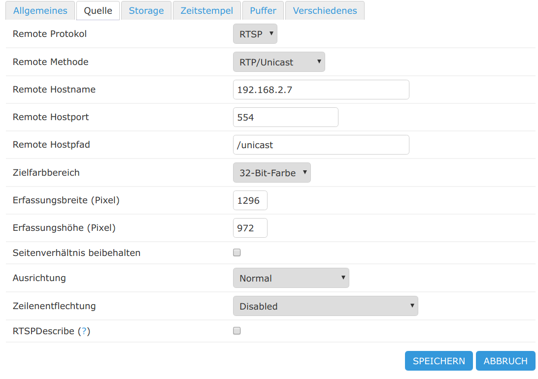

Hello everyone,
I'm using a Raspberry Pi as a camera.
The camera settings on the RPi are
v4l2-ctl -c scene_mode=8 -c exposure_dynamic_framerate=1
I stream the video using h264_v4l2_rtspserver with the following options:
h264_v4l2_rtspserver -W 1296 -H 972 -F 10 -P 554 /dev/video0
The video stream can be tested with a video player, for example with mpv:
mpv rtsp://[rpi_ip]/unicast
This setup works with 1.30.4 using Source: Remote, Remote Protocol: RTSP, Remote Method: RTSP/Unicast (see attached monitor settings).

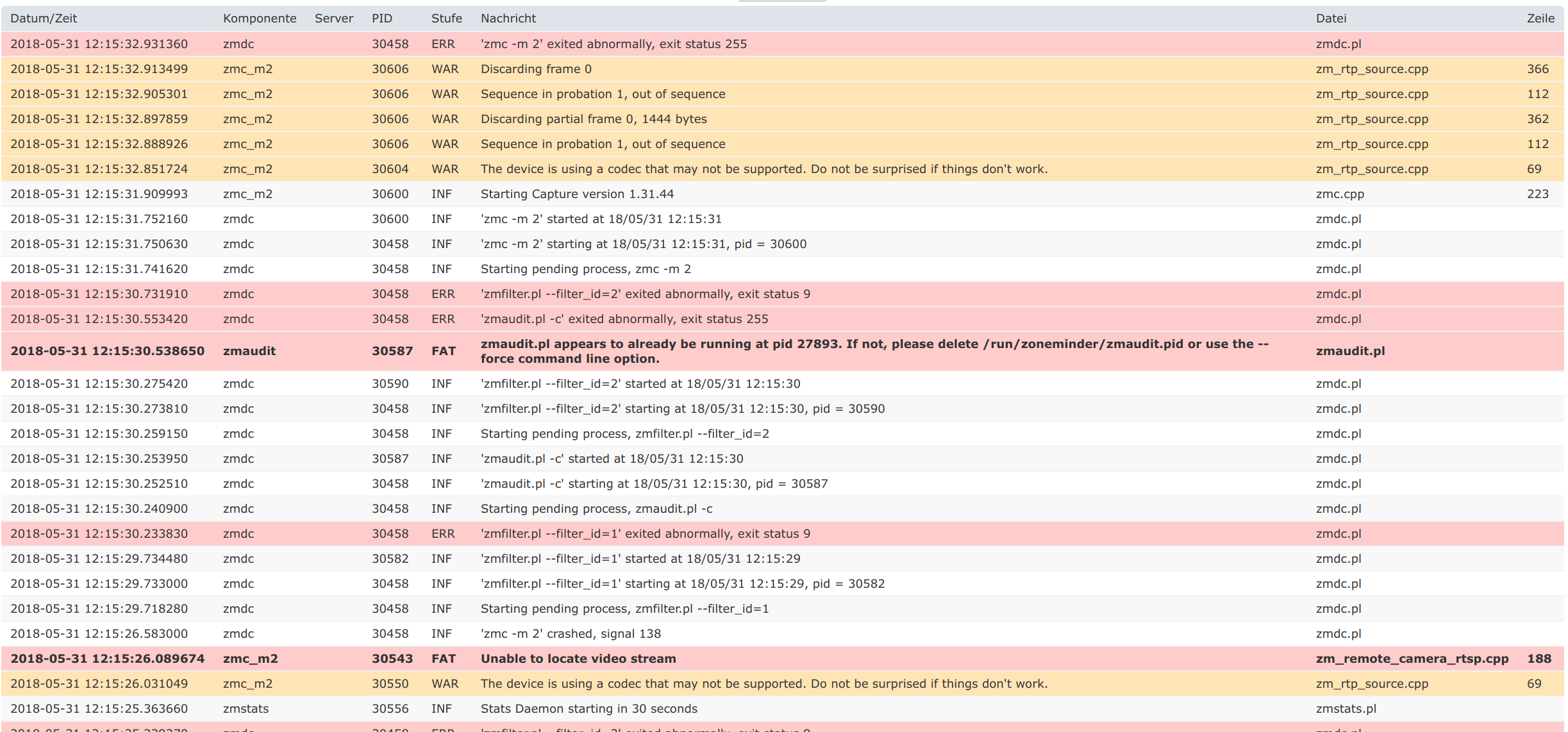

But when using 1.31.44, zmc crashes with one of the following errors (see attached Log 1 and Log 2):
  • The device is using a codec that may not be supported. Do not be surprised if things don't work. -> Unable to locate video stream -> 'zmc -m X' exited abnormally, exit status 255
  • The device is using a codec that may not be supported. Do not be surprised if things don't work. -> Sequence in probation 1/2, out of sequence -> 'zmc -m X' exited abnormally, exit status 255
