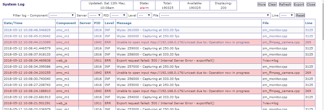

Bleeding edge question here. I have a V2 wyze camera running openipc. (From what I understand it's the same underlying hardware as Xiaofang)
I'm trying to get it hooked up to ZoneMinder. So far I've been able to connect to the RTSP stream but when I open the monitor I get a blue screen.
Log screenshot attached (sorry for using a screenshot, when I tried to export the log to a text file I got a server error)
Has anyone been successful getting a wyze cam to work with ZoneMinder?
wyze cam running openipc

Use VLC to check the stream and resolution. Zoneminder will show the blue screen when the resolution is wrong.

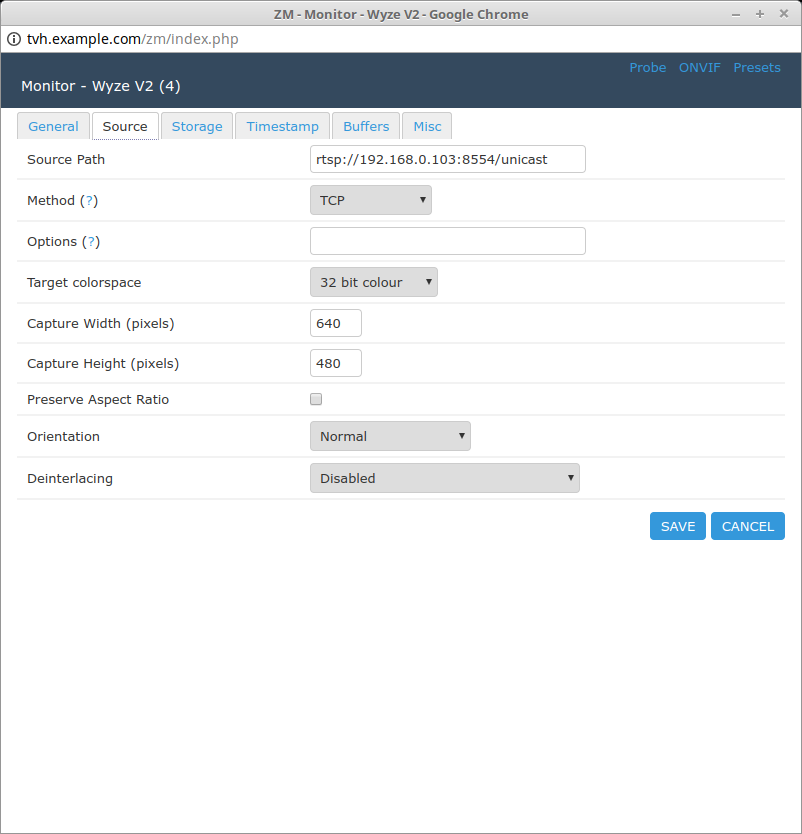

Looks to me like you need to add auth info.
rtsp://username:password@192.168.0.1/unicast

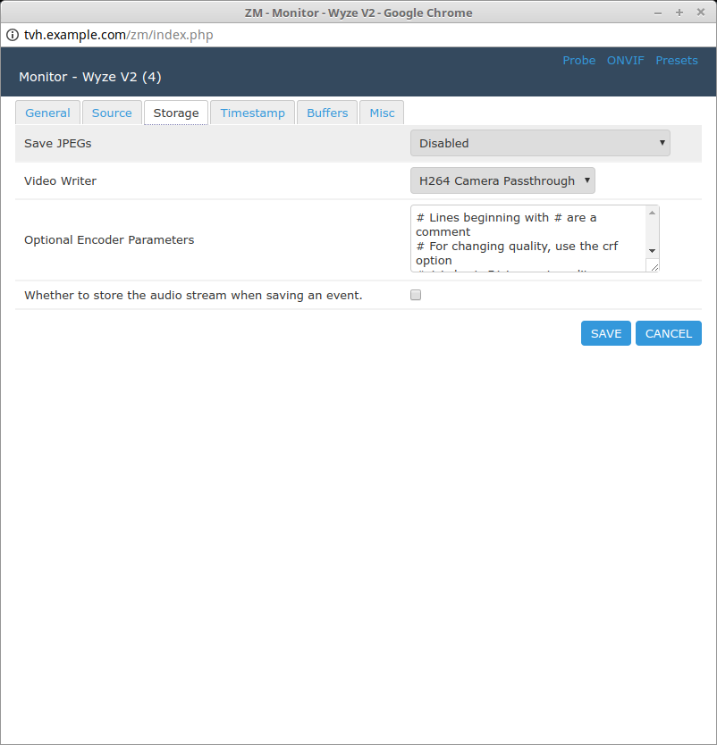

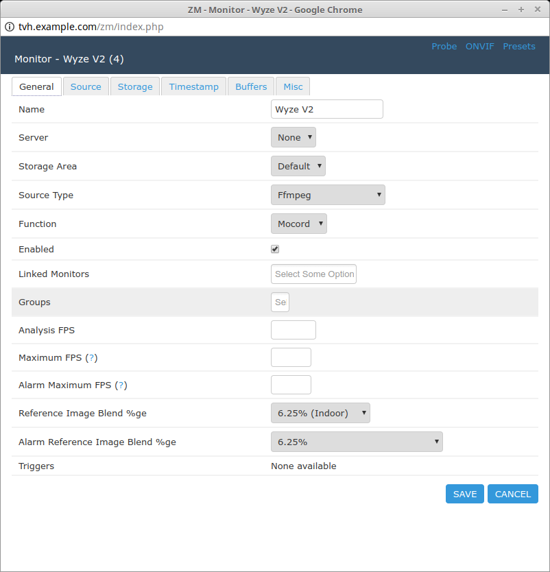

- tab1 settings
- wyze_tab1.png (60.47 KiB) Viewed 8246 times
- tab2 settings
- wyze_tab2.png (52.52 KiB) Viewed 8246 times
- tab3 settings
- wyze_tab3.png (46.62 KiB) Viewed 8246 times
Re: wyze cam running openipc
I THINK I FIGURED IT OUT.
I have only one camera connected right now, but you do need to make sure the IP is correct. I fell prey to the autofill of my browser and it tried to use another URL I had in that field recently. The IP was wrong. When changing the IP, I was able to get a feed. Then you also need to make sure you set the max FPS to 100 (at least that's what I set it to.) I have been streaming a WyzeCam V2 running OpenIPC to ZoneMinder on Ubuntu for the past 30 minutes.
It's a bit choppy at times, but with my current network speeds, I am able to stream a solid 10-15fps with an occasional 5 second freeze.
