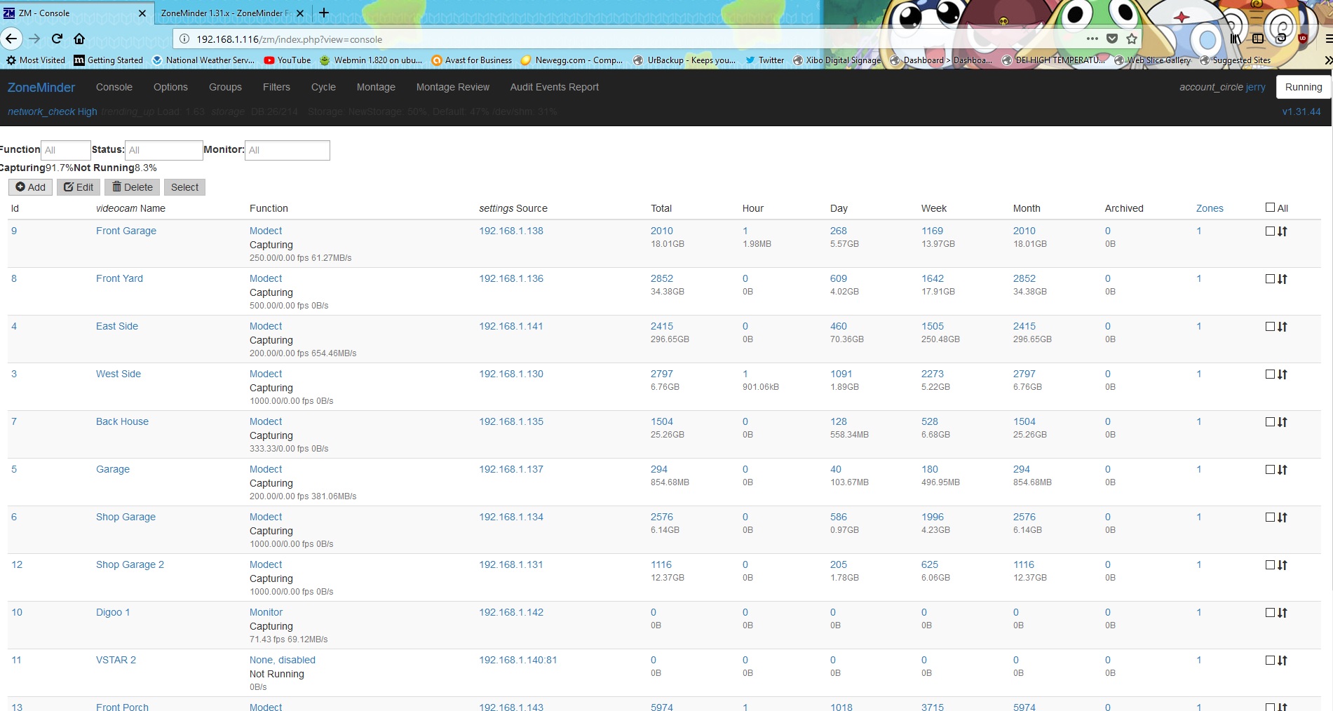

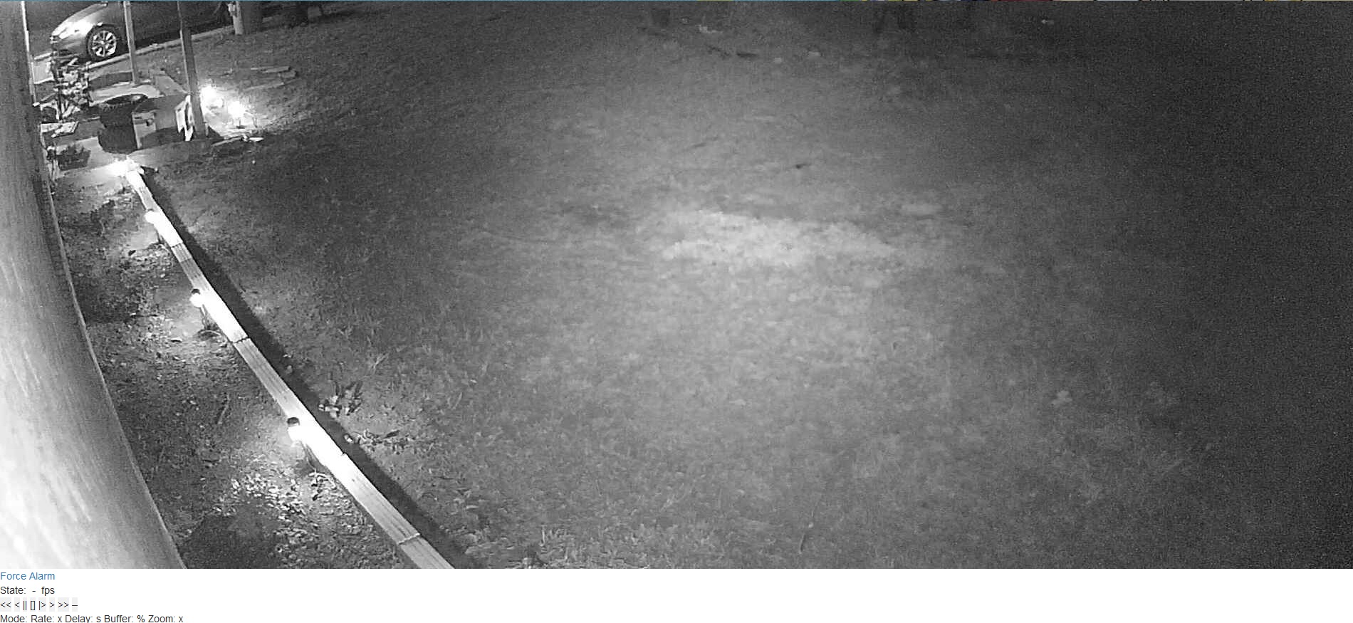

I just updated to 1.31.44 from .42 and the skin is doing weird things and when I click on montage it goes to a white screen and buttons missing. Running Ubuntu 16.04.3. Zmninja still works fine though right now.

There are additional apache config updates required.

ok, I did that and it fixed all that but I can't see anything when I open a cam to watch or open montage, its just blank and I right click and view image and it gives this "requested URL /zm/cgi-bin/nph-zms was not found on this server." and log says cannot find sock file.
Re: Layout messed up after 1.31.44 update
double check the configuration of the PATH for the /cgi-bin/....

After that update the layout actually got weird. I followed the guideline of opening the zoneminder.conf into conf-available and erasing all the contents and inserting the content of the gist Iconnor passed on correcting line 58 (indentation error). After changing the zoneminder.conf the layout was OK, but the images do not appear and the error log appears in PATH_ZMS. If I open restore the zoneminder.conf backup the layout gets strange again, but the cameras reappeared without the PATH_ZMS error. I believe there is some error in the gist script that is messing with PATH_ZMS.
