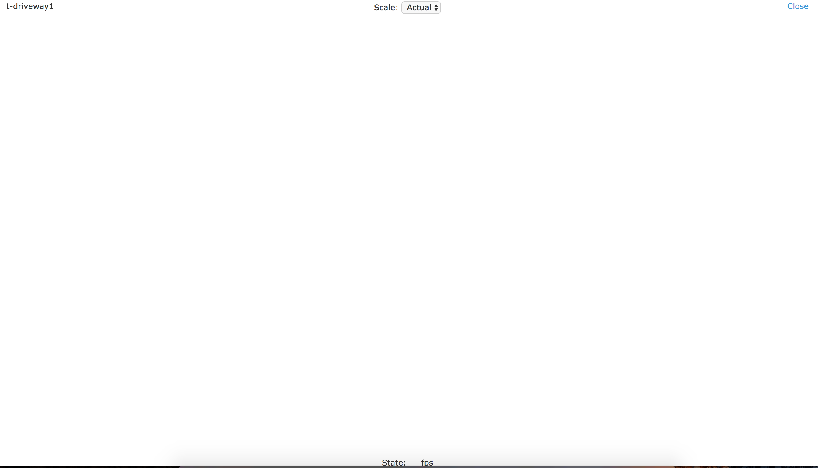

Every so often I see, what I think might be a timeout happening? The video in the web UI just never loads on a few cameras. When I check the log, I see the following error. It seems like the only way to get it back is to reboot the server or restart the zm service.
Running ubuntu and loads are pretty low.
Jan 2 16:04:16 zoneminder web_php[1206]: ERR [Socket does not exist. This file is created by zms, and since it does not exist, either zms did not run, or zms exited early. Please check your zms logs and ensure that CGI is enabled in apache and check that the PATH_ZMS is set correctly. Make sure that ZM is actually recording. If you are trying to view a live stream and the capture process (zmc) is not running then zms will exit. Please go to http://zoneminder.readthedocs.io/en/lat ... window-etc for more information.]

- Screen Shot 2018-01-02 at 4.06.32 PM.png (112.89 KiB) Viewed 6818 times

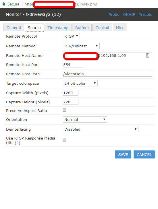

Ubuntu 16.04.3 LTS
Foscam FI9800P
I'd love to upgrade to 1.30.4 but when I do then zmninja breaks. I've tried a bunch of troubleshooting but end up reverting to a snapshot prior to the install, when the API fails.
Foscam FI9800P
