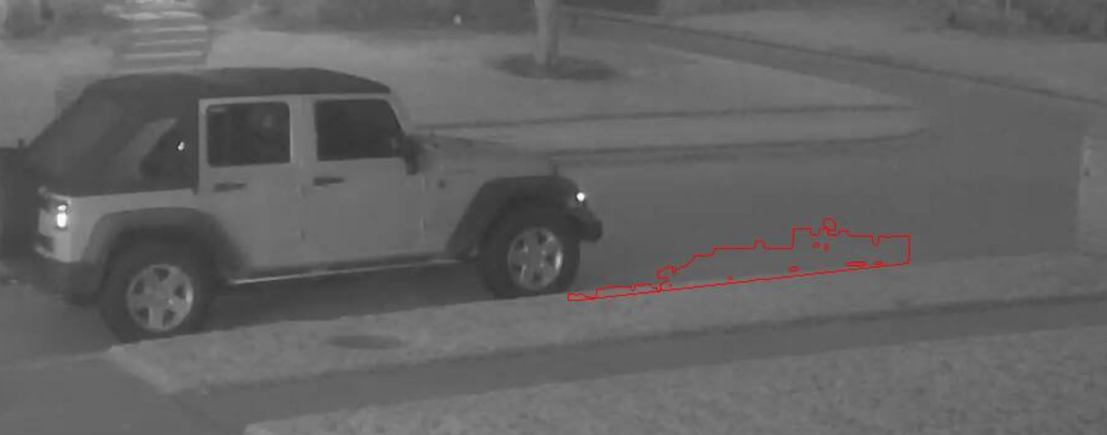

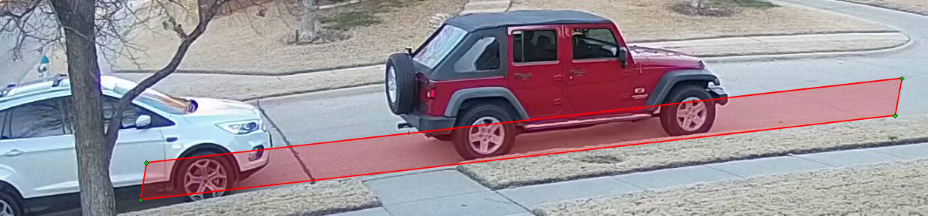

Hi - I have an outside camera that has 3 zones. Near dusk and after one (or more) of the zones produces an alarm that will record for hours. Thus, I need a bit of enlightenment as to which settings to adjust and why. I have gone through the wiki.zoneminder.com entry of Understanding_ZoneMinder's_Zoning_system_for_Dummies but still need a bit more information.
The stats associated with the alarm are:
Pixel Diff: 32
Alarm PX: 11560 (19%)
Filter PX: 9796 (16%)
Blob PX: 7781 (12%)
Blobs: 1
Blob sizes: 7781 (12%)
Alarm Limits: 1341,336-1624,421
Score: 12
I have included 3 images: The zone, the alarm, and the settings.
I am trying to make sure I can capture vehicles as well as pedestrian traffic - I just need a bit more insight to decrease the false alarms.
Thanks in advance.

Here is a quick summary of the issue I am trying to address. During the day the detection and alarms are working great. However, when 'we' shift to night, the system/settings start to fail. One observance is during the day the alarm is created by an object moving into a zone. At night, it is triggered by the light and absence of light. So at night the light from a car highlights an object such as a bush and that sets off the alarm. Unfortunately, once the bush is no longer highlighted, a section of grass, another bush, the road, the mailbox (pick one) has now changed from being lite to now dark (and thus a pixel change) and that generates an alarm and (near as I can figure out) since that now darken shape does not change, the alarm never stops - it goes on for hours or until daybreak.
So it appears that once an alarm is triggered by light, the alarm continues long after that trigger.
No idea how to address this.
