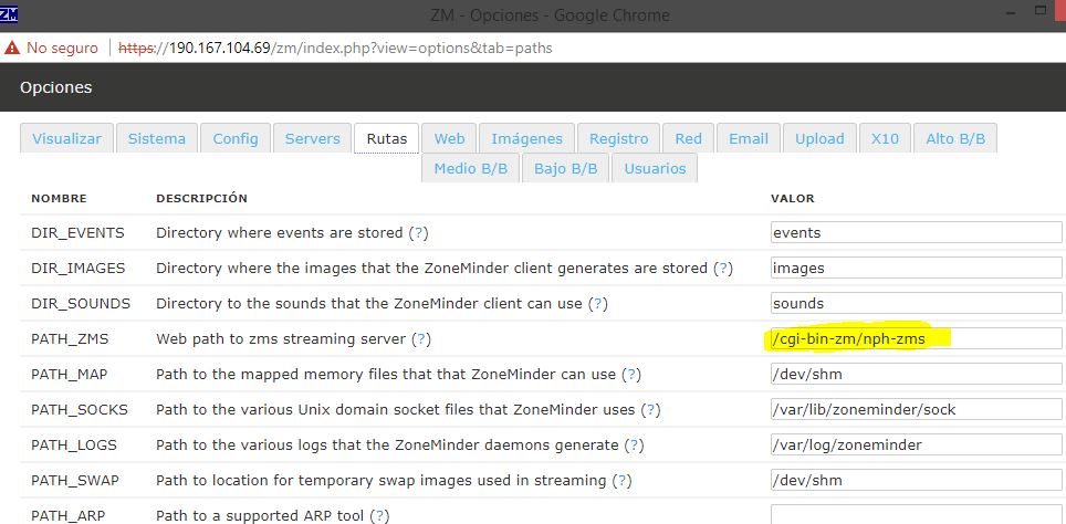

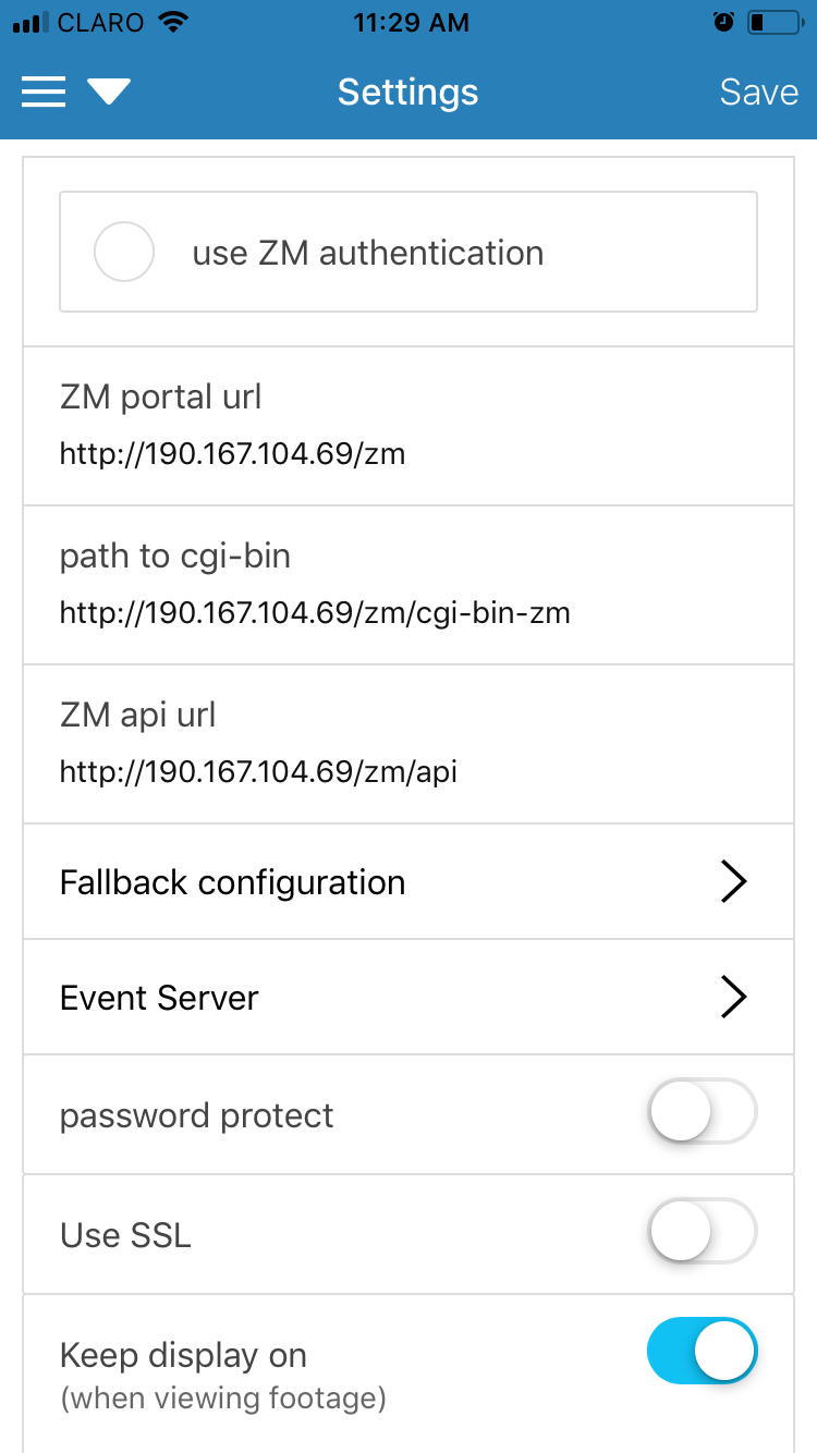

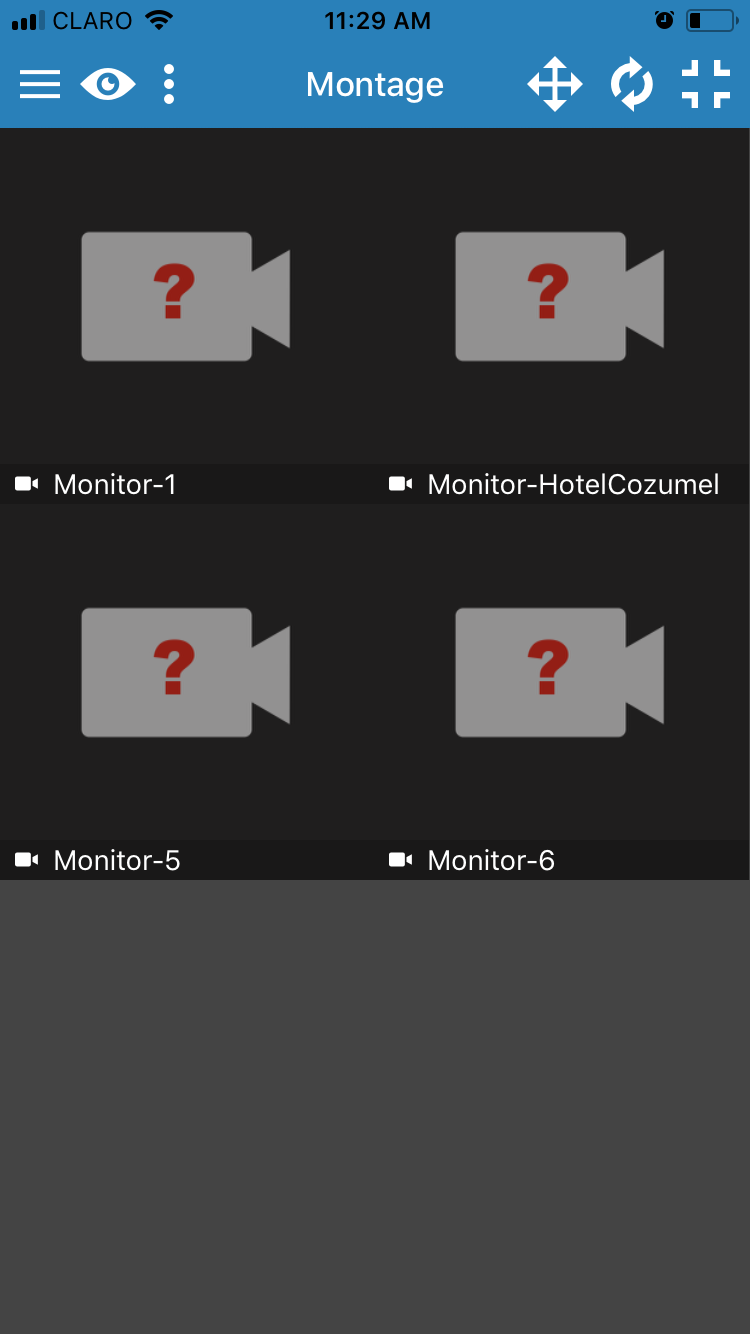

I just installed v1.30.4 on CentOS7. Everything is working fine, I can see my stream and events. However, after purchasing ZMNinja isn't showing my monitors on iOS.
I used the wizard and also followed the F.A.Q. without success. I think the issue may be related to the cgi-bin path. Right now I have "/cgi-bin-zm/nph-zms" on the web server and the full path "https://190.167.104.69/zm/cgi-bin-zm" on ZMNinja. HTTP Auth is disabled. Please see attached screenshots.

Settings look ok. Any chance you can come online to irc.freenode.net channel #zoneminder so we can debug? Also, try to use the desktop version first (easier to debug) - once we fix it, we can fix mobile https://github.com/pliablepixels/zmNinja/releases
PS: Enable ZM Auth and just put a dummy username password (x/x) or something - and see if that helps

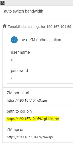

I tried the desktop app and got it working using the wizard. I looked at the path the wizard on the desktop app found and turns out the correct path to cgi-bin is "https://190.167.104.69/cgi-bin-zm" (notice the missing /zm). I placed that path on the mobile app and that fixed the issue.
I'm leaving this here for anyone having this problem.
