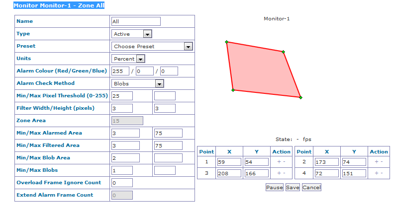

Edit - Just built a clean VM , 1.30.4 on Ubuntu 16.04.2 and the zones are working correctly, as seen by the attachment.
also Sorry, your browser does not support inline SVG is a red herring as it shows in the working browser.
