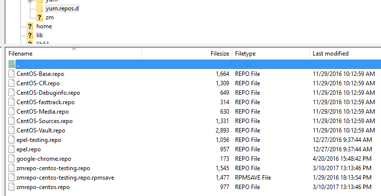

Is there some /etc/yum.repos.d file I can hack manually, to get these updates working again?
I am running CentOS Linux release 7.3.1611 (Core)
here is what I have now, looks like things maybe went south after the zmrepo update 3/10/2017 ?

See the memo posted back on March 12:
viewtopic.php?f=36&t=25937&p=99335&hili ... epo#p99335
Due to the timing, that might be the issue. I guess I removed the sticky status of that thread too soon.
If that does not resolve the issue, then please post your entire yum output. Do not leave any bits out. The information posted previously, left out the parts which would give clues as to what the problem might be.

Ah-hah!! well, interestingly enough, today yum update worked perfectly, no dependency issues. (Now on 1.30). :-D
I did have to refresh my memory on getting ZM restarted - dug around and recalled that perl /usr/bin/zmupdate.pl would do the trick... and it did!
Thanks muchly
