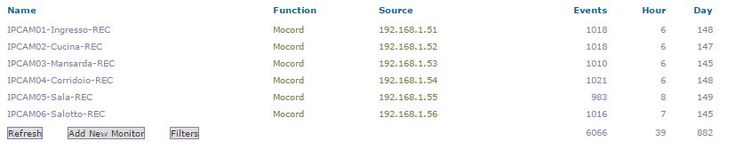

I have 6 IP camera configured in Mocord. I record 7 days and with a filter I delete older recordings.
What it happen is that for only a couple of camera, some events missing.
Whay I mean is that I record event of 10 minutes, so what I expect is 6 event per hour and 144 event per day.
Sometime i have less event.
I checked the event list and what i can see is that sometime event do not end at 10 minutes but before.
In occurence with a recording truncatet, i found this in the logs:
02/13/2017 01:14:12.421266 zmwatch[22422].INF [Analysis daemon for  IPCAM05-Sala-REC needs restarting, time since last analysis 9 seconds (1486944852-1486944843)]
02/13/2017 01:14:16.929391 zmwatch[22422].INF [Restarting analysis daemon for  IPCAM05-Sala-REC]
after this 2 logline @ 01:14:17 my recording stop and start a new one.
I cannot understand why this happen, only on this camera that is configured and same model of others.
Here an Example, for IPCAM05 I have less event than other:
Event count
Event count

marcolino7
Posts: 73
Joined: Wed Sep 16, 2015 12:20 pm
Re: Some recording missing in Mocord mode
Post by marcolino7 »
i keep situation monitored.
It seems that continous recording stop and restart, when a cam detect lots ov movement. I don't know if this is cause due camera fails due lot o data to be trasmitted or ZM fail to handler the data too.
Here is the logs for last occurence:
