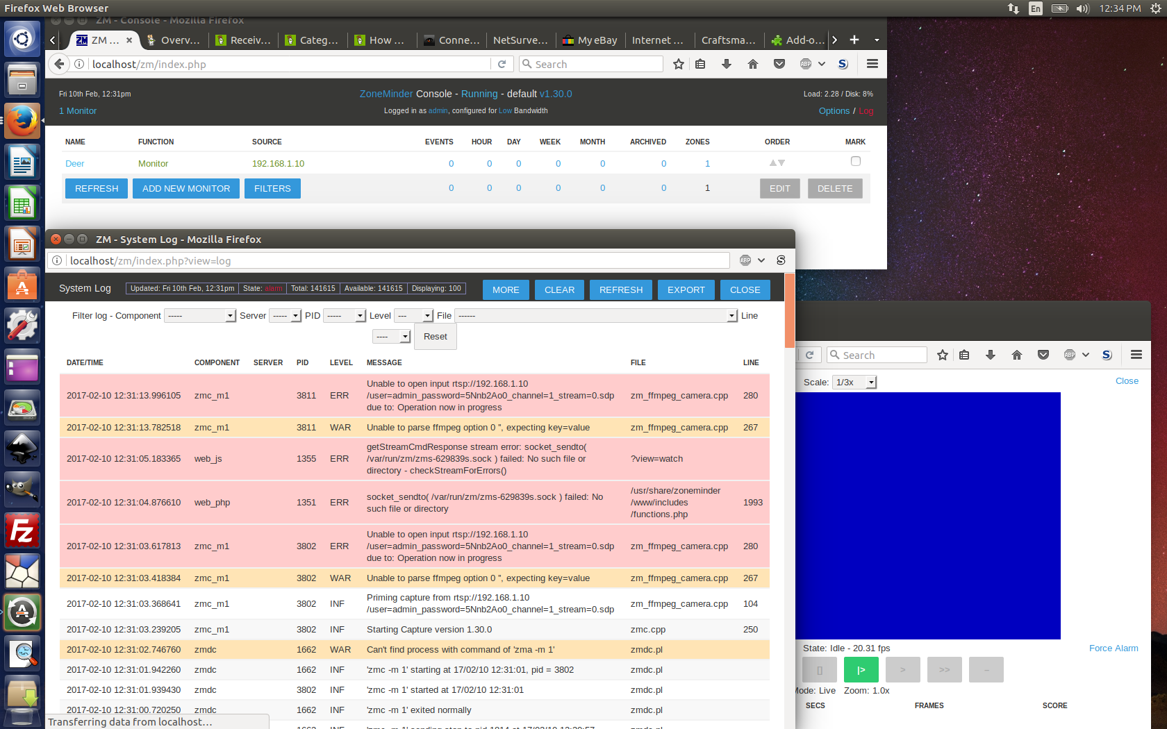

VitalBodies
Posts: 6
Joined: Wed Feb 08, 2017 9:37 pm
Re: How to change camera IP on Ubuntu?
Post by VitalBodies »
Here is what I see:
Screenshot from 2017-02-10 12-34-16.png (641.85 KiB) Viewed 12029 times
moonsky
Posts: 6
Joined: Wed Feb 08, 2017 10:58 pm
Post by moonsky »
You may be forced to use the manufacturer's plugin in order to change the camera settings. An .exe would need to run on a windows machine.
As far as the code for the camera source path, it shows 5Nnb2Ao0 as the password. You could try leaving this field blank and see what you get. Again I just did a quick google search for your camera's model # to find the rtsp path. You may want to do some further research and try different options.
The path without a password would probably look like this:
rtsp://192.168.1.10/user=admin_password=_channel=1_stream=0.sdp
Although, I am not sure if the password field would be left out completely if there is none. Try to see if you can find any more information in the camera documentation or through some web searches.
