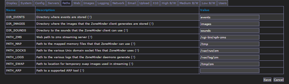

Hey Guys,
So i am having a little issue.
I am not getting any streaming from the web GUI.
I had a look at
https://zoneminder.readthedocs.io/en/st ... -streaming
I am running on FREENAS 9.10
And i am using NGINX not Apache like the GitHub suggested .
Since i am running NGINX the guide doesnt really apply.
Should i switch to Apache?
Any Pointers or Direction would be awesome thanks guys

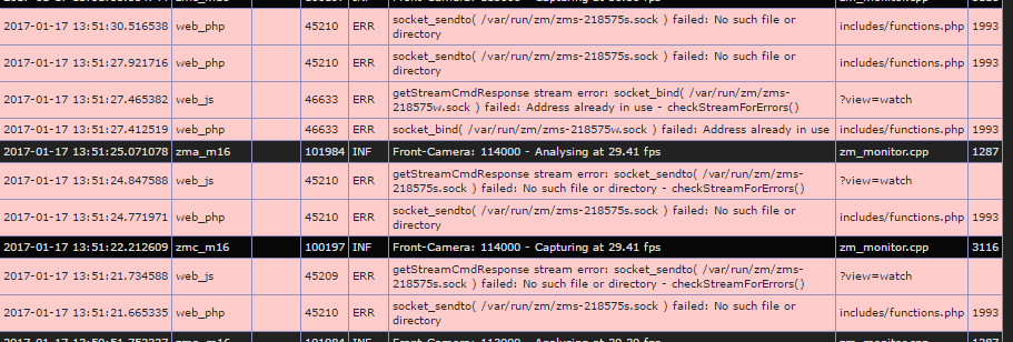

Any Ideas Guys ?
I see the socket being created in the directory it is looking for? however it can not seem to bind to it....
